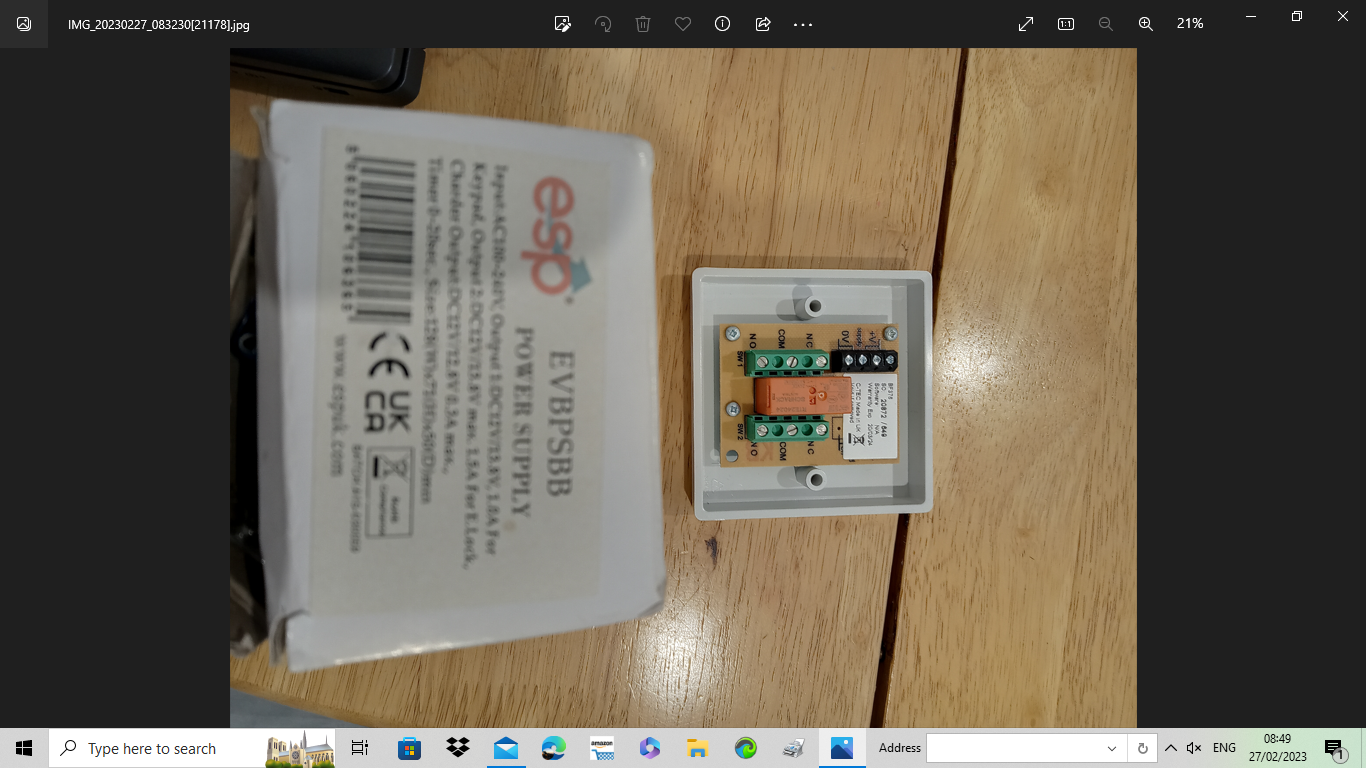

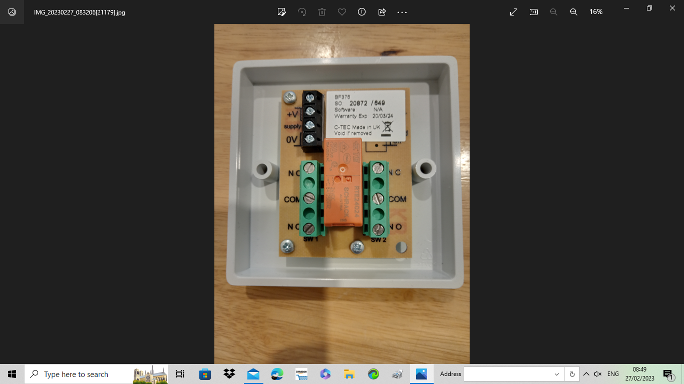

Have a door in a hotel that requires to be held back on wall with magnet and released on fire alarm activation.can only wire of nearest sounder as panel to far away .it's ctec 24 volt conventional system.undure how to carry out wiring to relay and PSU .I have a 5amp relay plate and 220v/13v PSU any help on this would be greatly appreciated PsS a wiring diagram would be greatly appreciated đź‘Ť

You’ll need a 24v NC relay…. (Normally closed) so it’s ON, and allowing power to the magnet.
On the alarm, 24v from the sounder will trigger the relay to open, thus cutting power to the magnet.
With your PSU, if you’ve already got it, you’ll need a 12v magnet.
There is no interconnection between the relay coil at 24v and the switching contacts at 12

Hi thanks for reply not sure if that PSU is ok as I require 24 volts says 12v 13.8 v output
Not sure on wiring connections to relay, Will I require 24 v to supply relay .

Check that PSU, I’m sure the box there says output 12v/24v DC…. Not very clear photo.
The relay has NC connections, so basically acts as a switch between Common and NC, and switching to Common and NO when power is applied to the supply + and - above. Although it doesn’t state on the terminals what voltage to use.
