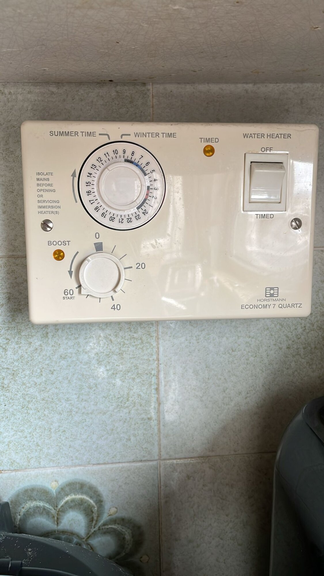

Hi
I have a HW tank in a property ( to be rented, in Scotland) that has been fed from an off-peak supply, with a 24hr boost function, to a single heating element. The tank only has 1 element. A spark has been in to change over old fuse boards and provide an ECIR.
He has advised that only 1 supply can be connected to the heating element, so I've asked for that to be the off-peak. Effectively it has no 'boost' facility now, to top up HW on demand. The spark says that it is NOT OK to connect the 2 supplies to the single element, in case they ever happen to be supplying at the same time. I guess a dual-element HW tank would be the solution.
I'm just seeking confirmation that I've been given the right information.

So do you have a dedicated off peak consumer unit and a 24 hour consumer unit , another question is the hw element long top entry. Just to add the whole supply goes over to off peak so you could switch the circuit over to 24 HR supply and have it on a time clock that way you could top up if need be.
The 24 HR supply (general domestic) should going over to off peak too , you say to separate meters lmo check with your energy supplier that is the case else or would mean 2 element tank and 2 circuits one off peak one 24 HR (general domestic)
A white 'flex' cable feeds the single element on the tank. It was 3 cores plus earth, so assume it had 2 lives. It comes from a point on the wall near the tank, which is back-to-back with this boost/time clock in kitchen. I'm not sure if the 2 lives feed direct from this box. Or if this only supplies the 24hr boost feed. But the fact it has a timer on it makes me think that this device could manage whether an off-peak or 24hr feed was sent to the tank (and so avoid sending 2 live feeds at the same time....which is what the electrician says needs to be avoided).

Well what does your electrician say he should know he has changed the consumer units what is there to assume.
