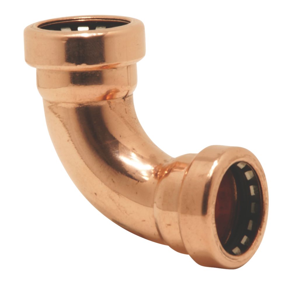

Do you mean the plastic fittings that can also fit copper pipes, or the metal fittings with similar grips?
In the plastic case i would not expect much conductivity but it would depend on how pure (specifically how ionic) the water was. Central heating systems with anti-corrosion stuff might be more conductive than tap water.
For the metal fittings it could be the same, down to a low-ish resistance joint if they have any of the 'one way' spiky gripping washers that can touch both metal parts.
TL;DR could be anything from dead short to 100s of k Ohm!

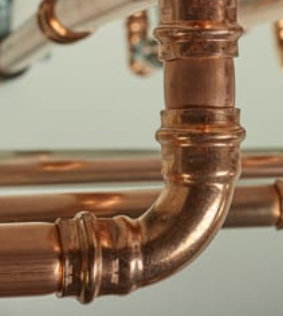

Pressfit type copper should be making a good contact from fitting to pipe as the fitting distorts the copper when compressed.
I guess the best way to assay that is to do a test at an individual joint each side, no? My own exeprience with these joints is that there is good metal/copper contact so I would not think they are the cause. Maybe the electric tail rail is not properly earthed?
Yep, I think those are the ones. You would expect them to have a reasonable connection. Not a whole lot I can do about it now but it did have me wondering. I’m sure the place was re-piped when the job was done and the main bonds are there so it seemed a little odd. I might need to look into it when I next seen them fitting the stuff and try a test section to see what it shows.
I’m thinking I’ll do some checking to see what values the joints throw up. The rail is a dual fuel but there is no issue with the cpc or values at the flex outlet.
Doh, I forgot those are the crimped ones!
I was thinking of this type:
https://www.NoLinkingToThis/p/tectite-sprint-copper-push-fit-equal-90-elbows-15mm-10-pack/689fj

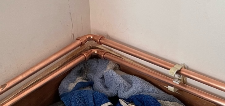

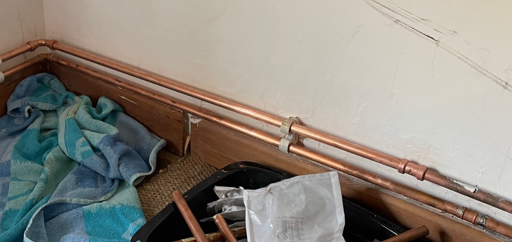

Going off topic, but funny you should mention those. I used those at a friends house last week to re-route some heating pipes - they had gone around a chimney breast but the chimney was removed.
Irritatingly when the system was re-filled the bottom one leaked. No idea why, maybe I missed a burr on the pipe. And I couldn't find the removal tool!
So I ended up cutting the bottom pipe out again and putting a new section in with yorkshire solder fittings and slip-couplers.
The funny thing is that the result is the top pipe looks very DIY and bottom pipe looks more like a plumber did it.
It would have been quicker to do both pipes properly in the first place but I only play with plumbing about once a year and thought the push fit would be easier. Lesson learned!
