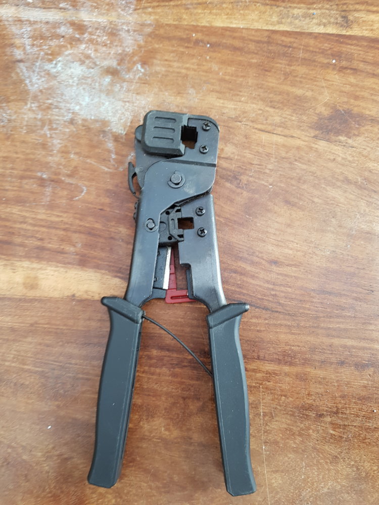

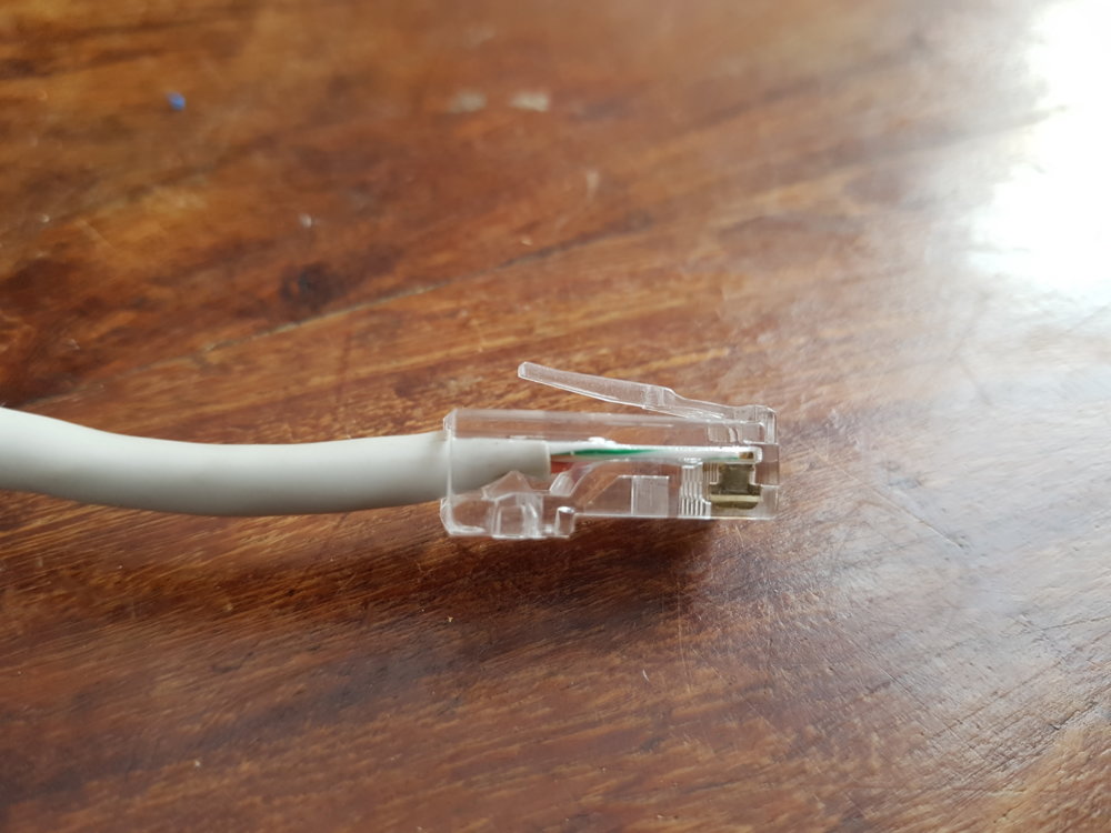

I have fitted RJ45 connectors to either side of a piece of cat5 cable but when I test it on the laptop I get no ethernet connection. I also have a pre-made ethernet cable which works fine so I know it's my home made ethernet cable. I cut the cat5 to 12.5mm and connect both ends the same (i.e s68A)
I have practised this a few times now each with the same result, i.e. it doesn't work.
With a piece of twin and earth I could test for continuity at both ends but how do I test for continuity through an RJ45 connector?
The problems that I can see it as being are the following but I dont know which is the most likely or if there are other problems I missing?
1. Poor quality connectors, not actually making contact in the laptop or router.
2. cat 5 not actually terminated inside RJ45 connector
3. RJ45 Crimping tool not effective which leads to 2 above.
Cheers all.
View attachment 56235 View attachment 56236 View attachment 56237

Just buy pass through connectors and a pass through crimping tool, 10 x faster and accurate.

Looking at those pics, I agree that the cores are not fully inserted - they should reach to the very end of the channels so that when you look at the end of the connector you can see both the conductor and insulation clearly on each core.
Also as mentioned above, the sequence is wrong. It is not sufficient that each pin at one end is connected to the same pin at the other. Splitting pairs (e.g. swapping one orange with one blue but putting them right at the far end) will completely scramble the transmission as the go and return of each of the four circuits must form a twisted pair to have the correct characteristics.
Yes, you are right they were not pushed in far enough. It seems to work fine now I have inserted them further in.
With regards your last paragraph I'm not sure what you mean as I believe I have the sequence correct? If you see post #6 you will see I have used T568A, however I realise T568B is usually used. Does it make a difference which one you use?
No. As long as you use the same method at each end. Most modern equipment will auto-sense A or B sequence if it's relevant.

Yes, my apologies, I thought at first that the brown/white and orange/white were interchanged but now I see it on a proper screen it is indeed correct 568A.

@happyhippydad if its any consolation I always find them fiddly to do whether cat 5 or 6. Wires are too small and my eyes are too old. Best advice I can give is to take your time and allow for lots of waste to be cut off. I also use the Klein crimp tool and the through type RJ45 connectors
