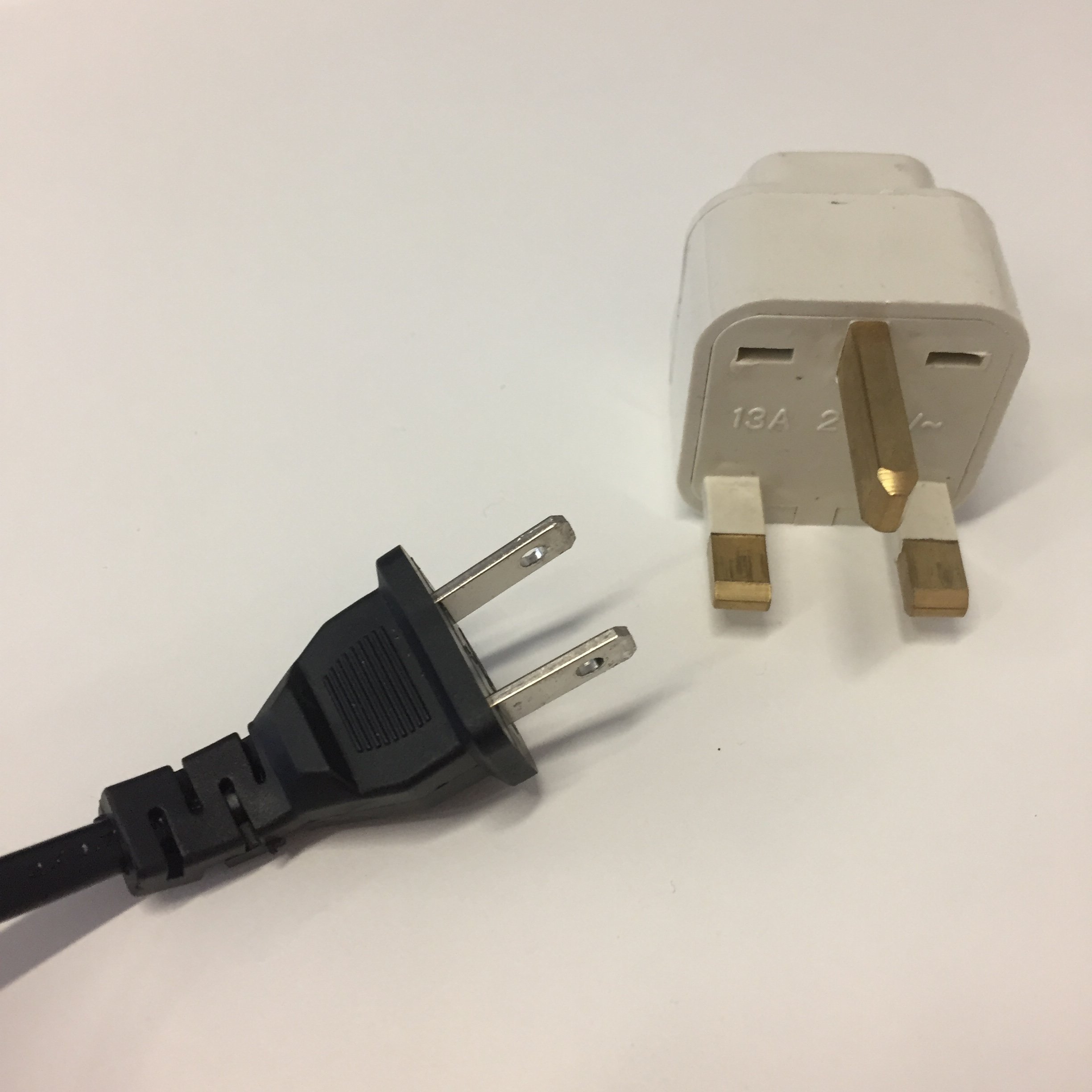

Hi,
I've bought several table lamps that each power a 7w E12 bulb. They have US plugs and were sold to me with very dubious looking US>UK adapters. (I ordered online from Thailand and was promised UK fittings. I know, I know...) The connections are poor and the bulbs often go when switched on. I've had them so long now and the complexities of sending them all back, let alone the inevitable to and fro, means speaking to the maker isn't an option that I'm considering.
I want to replace the US plug/adapter combo with a 3 amp UK plug. Can I just cut the cord and rewire it? There will probably be no earth wire. Does that matter? Does the cord need any specific shielding if it has a UK plug on it?
Lots of info online is conflicting. I hope you can help. Thanks!

Are the old plugs you intend cutting off and replacing wit a UK type 13A plug top connected to any sort of transformer? can you post a picture of the existing?
The plug is this simple 2-pin one, fitting into an adapter that I presume has a 13amp fuse in it. Could be wrong...
The colours or Colors may be black and white in the cable not blue and brown , i think black is the live (hot) and white is the neutral (cold) but best check with others
Great feedback, people! Thanks.
So I will cut the cords, discern live and neutral, add a 13 amp (?) fuse to a BS1363 plug and see if that works.
Low wattage filament lamps are like that. Can you fit LEDs?
Constructional standard may not be technically compliant with UK regs but at the moment the most dangerous thing by far is probably that nasty adaptor.
