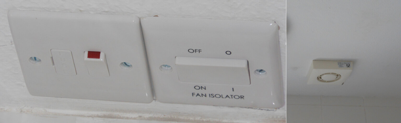

I somehow feel my work does not compare, probably the most complex and interesting install I have done recently is an extractor fan:thumbs_down:!
Though I do not usually photograph my work (and probably would not want to post it anyway!)
Different worlds:yesnod:

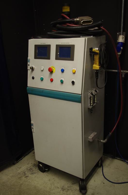

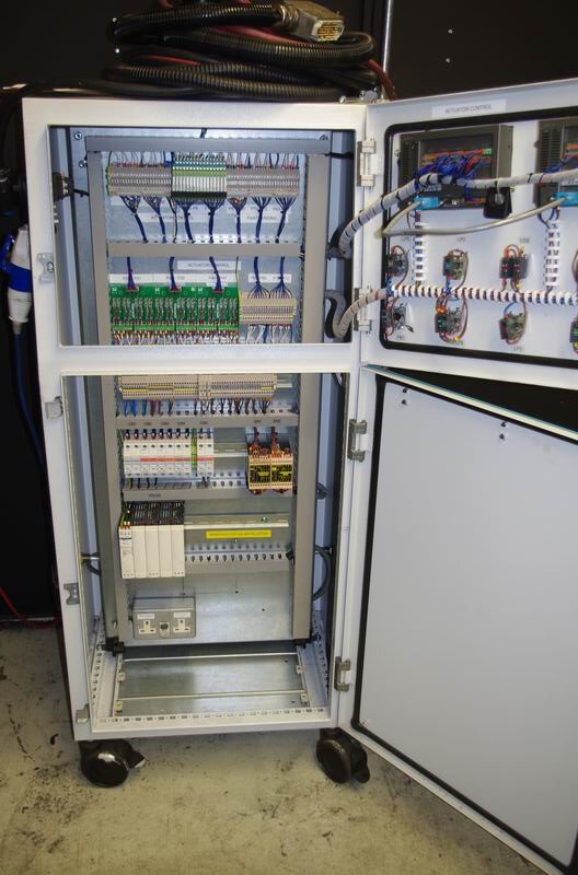

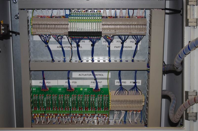

We used to change the tooling over on a couple of the welding robots about every 3 weeks but could only fault find once it had been installed which meant downtime/lost production.
I built the panel to test/simulate the sensors, solenoid valves etc. prior to the changeover, I designed it so it could also be used as a manual welding fixture if the robot cell was down.
