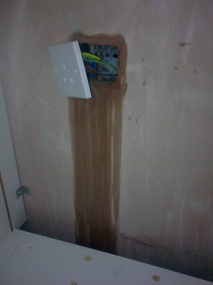

Now we have all heard of weeping statues/religious relics etc......
This was the house that John Wayne built,
New build (<1yr), builders done a bunk, electrician has gone bust!
1g non switchable, behind built in, infact massively wedged/no more nailsed in fridge freezer with NO spur/accessible isolation!
Checked every other socket/spur in the kitchen, decided it had to be the fridge/freezer, ripped out a large proportion of kitchen to get at the socket!
When the shower upstairs is used water gushes down the oval conduit and litteraly pours out of the socket, thankfully tripping the RCD!.
