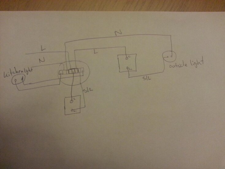

i wired kitchen florescent loop in method then i took live feed for outside light (flood light with sensor) direct to switch then to light.when i switch kitchen light on the outside light switch come on as well.can anybody help me with this please.

I hope for his sake it is a DIY question. Take a pic of how you've connected it up and post it. Sounds like you've connected in the switch live and not the permanent live.

Draw out your circuit Derby and see if you can see where you have gone wrong... maybe you have connected you O/S light to the switch wire instead of the permanent live in the fluorescent fitting thus the OS light comes on in power up mode when you switch fluorescent on.

no outside light come on normal with his own regardless of kitchen light.if the outside is switch off and you turn the kitchen light on nothing happen to out side light. but if you turn outside light switch on after 1 min it goes with sensor timer then if you turn the kitchen light on out side light come on

20140107_214801.jpg This is my circuit daigram.

diagram looks OK. to me. should work.
just wondering if it's anything to do with the kitchen light being a florry.
I have had this problem on a fault I was called to. It turned out to be fluorescent light in the kitchen, I changed the starter in the fluorescent and it cured itself. the outside light was one of the cheaper ones.

As per post above, possibly the starting transient of the fluorescent is triggering the PIR spuriously. This could indicate excessive voltage drop on the circuit, or that the PIR is unreasonably sensitive to mains spikes. Either try a different PIR, a different starter (because the suppressor in the existing one might be duff) or possibly better still, fit an electronic 'Pulsestarter' in the fluorescent in place of the glow starter.
E2A You can confirm that this is the problem and not a wiring error, by first removing the starter. If the PIR now works normally, it's probably interference from the florry. If it still malfunctions, it's your wiring.
Check, check and (in your case) triple check your wiring! If it is not your wiring then you will be doing a lot of guesswork - easier to take the fitting back, claim it is faulty and get a more decent brand to replace it.
when i press switch 1 switch2 light come on as well
