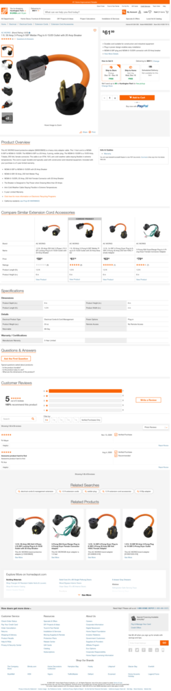

I already have a 50amp welder outlet installed that I hope I could use the below adapter to run the bandsaw and drill press. It has a 20 amp breaker in it though, and I don't know if that will be safe.
1 ft. 50 Amp 3-Prong 6-50P Welder Plug to 6-15/20 Outlet with 20 Amp Breaker​

The link works for me, maybe you could copy and paste it in the URL bar if interested.

Ah, it doesn't work for me because I am in the UK. Perhaps you could post a screenshot of the page?
