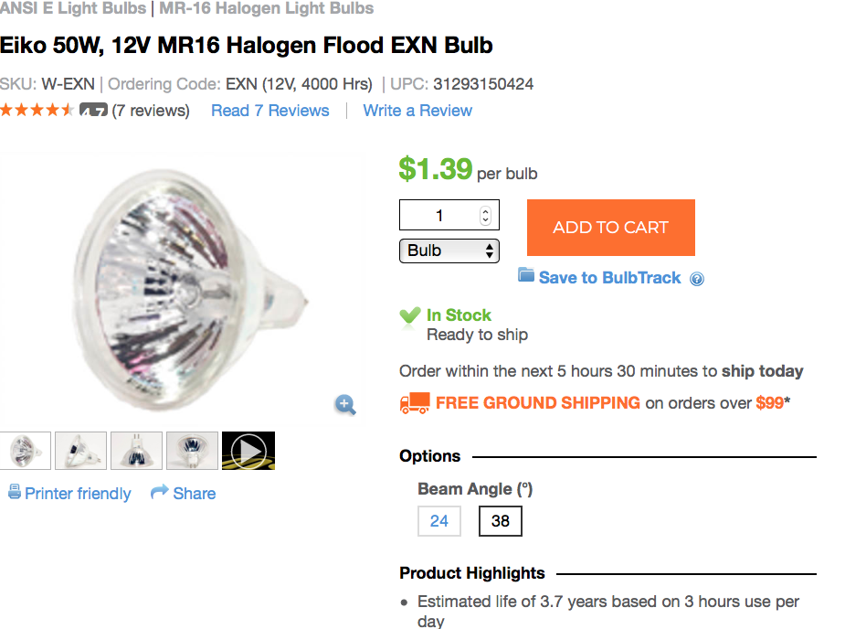

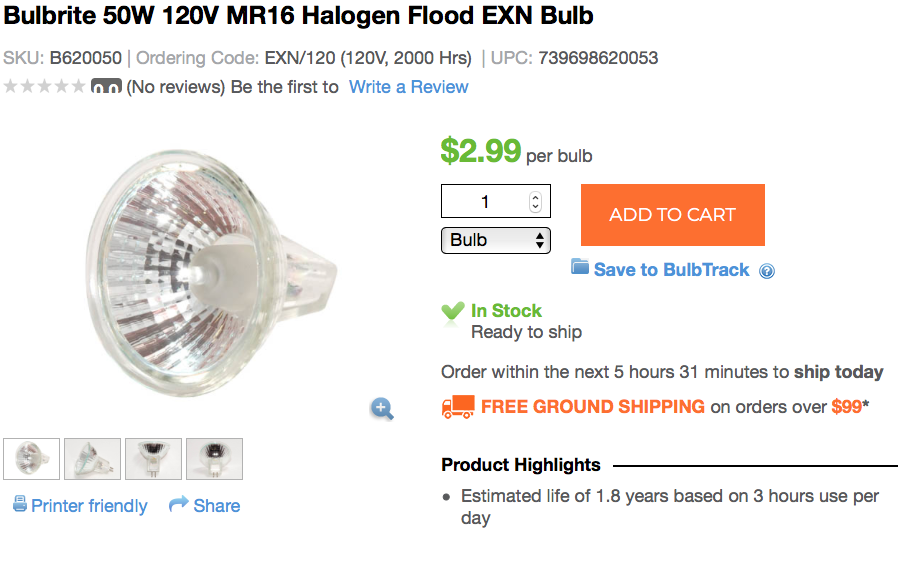

I did find a 12v bulb with the same GU5.3 base (all the specs are identical between the two bulbs). And no, no 120-volt LED equivalent exists. There is a 12-volt LED, but with a different socket.
So, is rewiring the lamp for 12 volts really as easy as splicing the wires and adding a transformer plug? Is there anything more I need to know to make the lamp operational and safe?

Here are images of the two bulbs. The Bulbrite is the 120 volt. The Eiko is the 12 volt.

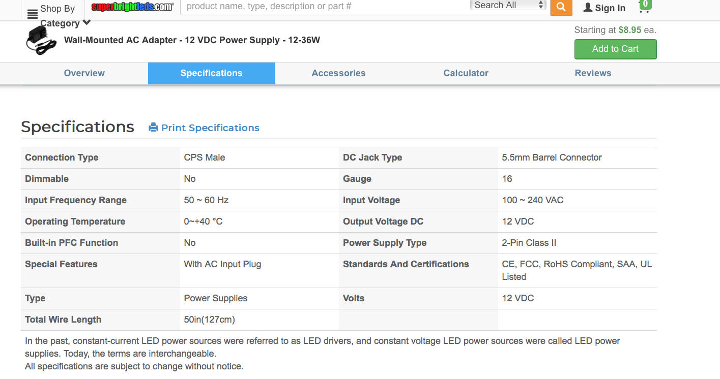

If you put a 12V bulb into a 120Vac light fitting then it will fail instantly. If your supply voltage is 120Vac then it is simple to have a lamp using that voltage and it would not have a transformer in the lamp.
Adaptors is the name given to a switched mode power supply that provides a dc voltage output in a similar manner to an LED driver, but they are more readily available and cheaper.
If Feit state that the bulbs can use ac or dc then you can use either an ac or a dc supply at 12V and the internal circuitry of the bulb will provide the correct input to the LEDs in the bulb.

You can use either 12Vac or 12Vdc, you cannot use 120Vac or 230Vac.
That is what I mean when I say you can use ac or dc at 12V.
Just buy a transformer or driver or power supply or adaptor that will input 120Vac and will output either 12Vac or 12Vdc and will operate when it has a load of 13.2W i.e. its minimum rating is below 13W and it maximum rating is above 14W.
Then wire this into your power cable to the lamp: safely, in a box and with no strain on the connections, because the cable is clamped.
Plug in the light bulbs, plug in the power supply and the lamp should work OK.

Do you think the bulb is wacky or is something wrong with my wiring? I got the adapter that you linked me to.
Can the bulb ruin my lamp? I have to wait till after Labor Day to get in touch with the manufacturer, but I need the light till then.
Led bulbs tend to have very concentrated light source that would be inconvenient to look at directly, but then again halogen are fairly similar in comparison to the style of bulb you have.
Brightness wise it should be a close match to a halogen bulb's brightness for illuminating an area, the beam angle is similar and the light output should be similar.
If the output is significantly brighter then I would feel there is something wrong somewhere but I cannot understand what could cause this, any errors in wiring should make the bulbs dimmer or fail to work, it would only be by supplying something like a 24V supply that the bulbs would be very hot and bright (and probably fail soon) but the type of power supply I suggested cannot supply a different output voltage, even if the input voltage were 240V the adaptor should be able to cope with this and still provide 12V output.
If the bulbs were wired in series in the lamp then they would be now very dim, if the adaptor was supplying 120V then the bulbs should fail instantly.
Possibly worth checking that the adaptor is a 12V power supply and not a 24V one and is also not one that has an adjustable choice of output voltages and been set on the wrong setting, usually a rotary or slide switch somewhere.
Other than that I am lost as to the cause.
I checked the specs on the adapter, and they are as advertised. The output is 12 VDC, and there is no adjustment possible. I’m attaching its spec sheet.
I have another question. When I pulled the plug from the wall to check the specs on the adapter, one of the wires pulled loose. The connector holds only about ⅜ of an inch of stripped wire in its slots. (I’ve attached a screenshot so you can see.) I tightened the screws as far as they would go. Obviously, it didn't do the job. Should I put electrician's tape around the end of the wires? Does this connector sound safe to you?
Thanks,
Tamara
If the wires are pulling out of the terminal then I would try doubling the wire back, ie. so that there is twice the thickness of conductor.
Bearing in mind the issues you are having, I would be tempted just to buy a new lamp all together. It can't be worth all this surely?
