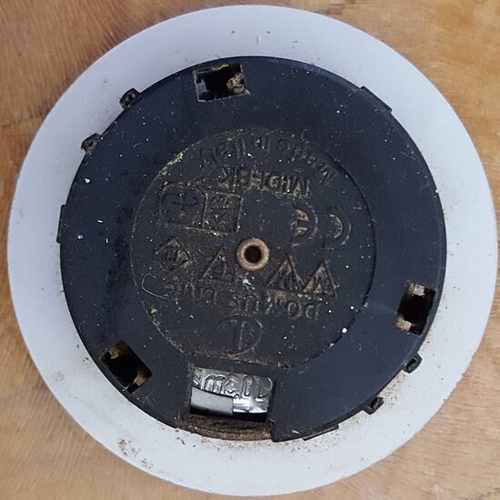

I've two LED downlights in the kitchen and can't get them working.

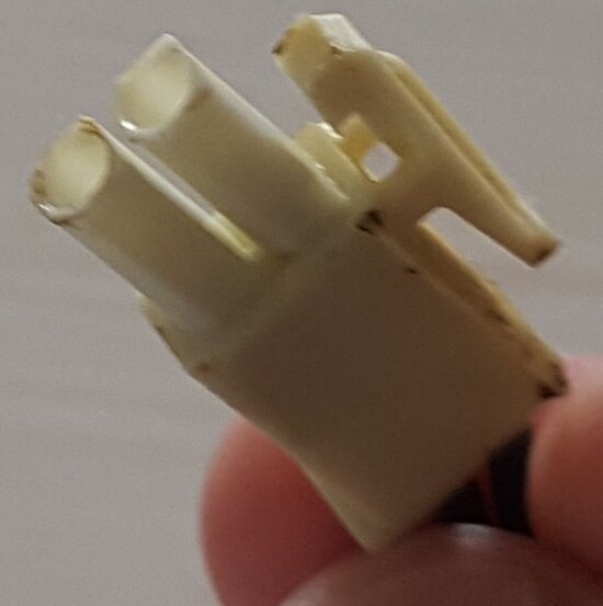

They work using a 2-pin plug like this

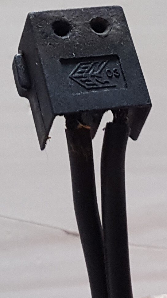

...and at the other end of the cable, the bulb connects to this...
... this bit sits in the below housing...
I know my LED driver is fine, because there's a third downlight on the same circuit. I've plugged it in to each of the driver outlets and it works in every one.
So the problem is somewhere between the plug (first image), cable, bulb socket, or housing.

Could the housing be the problem? I don't see how that could happen, because the bulb plugs directly in to the socket at one end of the cable.
It's odd, because I can't see any broken connections on the cable or really anything wrong with any of it. It seems such a simple circuit, but here it is, not working!

The molex style plugs are normally fairly reliable but the G4 lamp holder is two very thin tubes that take the bulb pins and these have probably become distorted so that the bulbs pins miss the connection.
Generally the lamp holder is not designed to be removed from the fitting, you may be able to buy a ready made cable assembly (presumably the manufacturers of the fittings get them) but it would require searching around to see who makes them. Probably readily available from China!
It would probably be easiest to buy a set of 3 G4 halogen cabinet lights and use the parts from that to fit your existing fittings.

Thanks so much - that's massively helpful. Not least because you've told me all the correct nomenclature... gets me a lot closer to finding the bits I'll need, all looks cheap enough, just need to find the right bits to go together... didn't realise the setup is better known as "cabinet" light rather than "downlight", even though in my house they're used as downlights. Also "G4 lamp holder" was a term I hadn't tried searching for, which has given me some good results.
