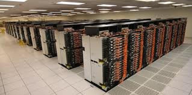

Hi, Have you got a link handy for a technical spec for these servers, or some similar? I'm struggling to imagine how a peice of IT equiment like that could possible require 9KW per rack..? thanks!
"Dont worry mum , this super-computer in my room is just for help with my homework"
Reactions: 1 person
Thats about the same size as the first one I worked on Biff. A 286 would have had more power! The hard (Winchgester) drives were wheeled around on what looked like hospital trollies. If we had to have the program altered it would arrive on punch tape.
