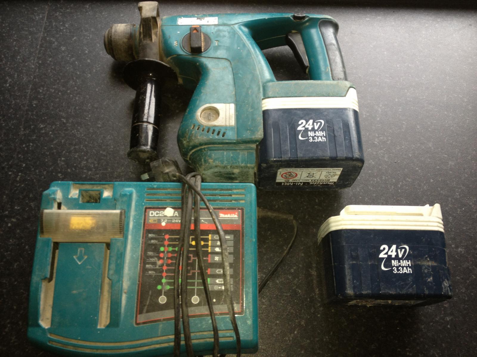

Hello
I am down to my last 24V battery now. Has anyone had one of the copy's off fleebay. Are they any goods. Drill is in good working order so begrudge getting rid of it but seems only choice due to original battery prices.

i've got 2 of them drills. fantastic tool. only pity is they're not Li-Ion.

Agreed, Love my BHR Makita 24V drill bought it second hand bare with 2 x2.0Ah batts (1 working, 1 dud). Recelled dud battery myself ÂŁ40 for 20 replacement 4/5AA batteries (only 2 dud cells in battery but better safe than sorry).
Good battery lasted another 2 years and last year I recelled it too, original recelled battery still going strong.
Only takes an hour to recell a battery yourself with the right tools. I can point you in the direction of a good company (If the forum allows) for replacement cells to repair cordless drill batteries.
