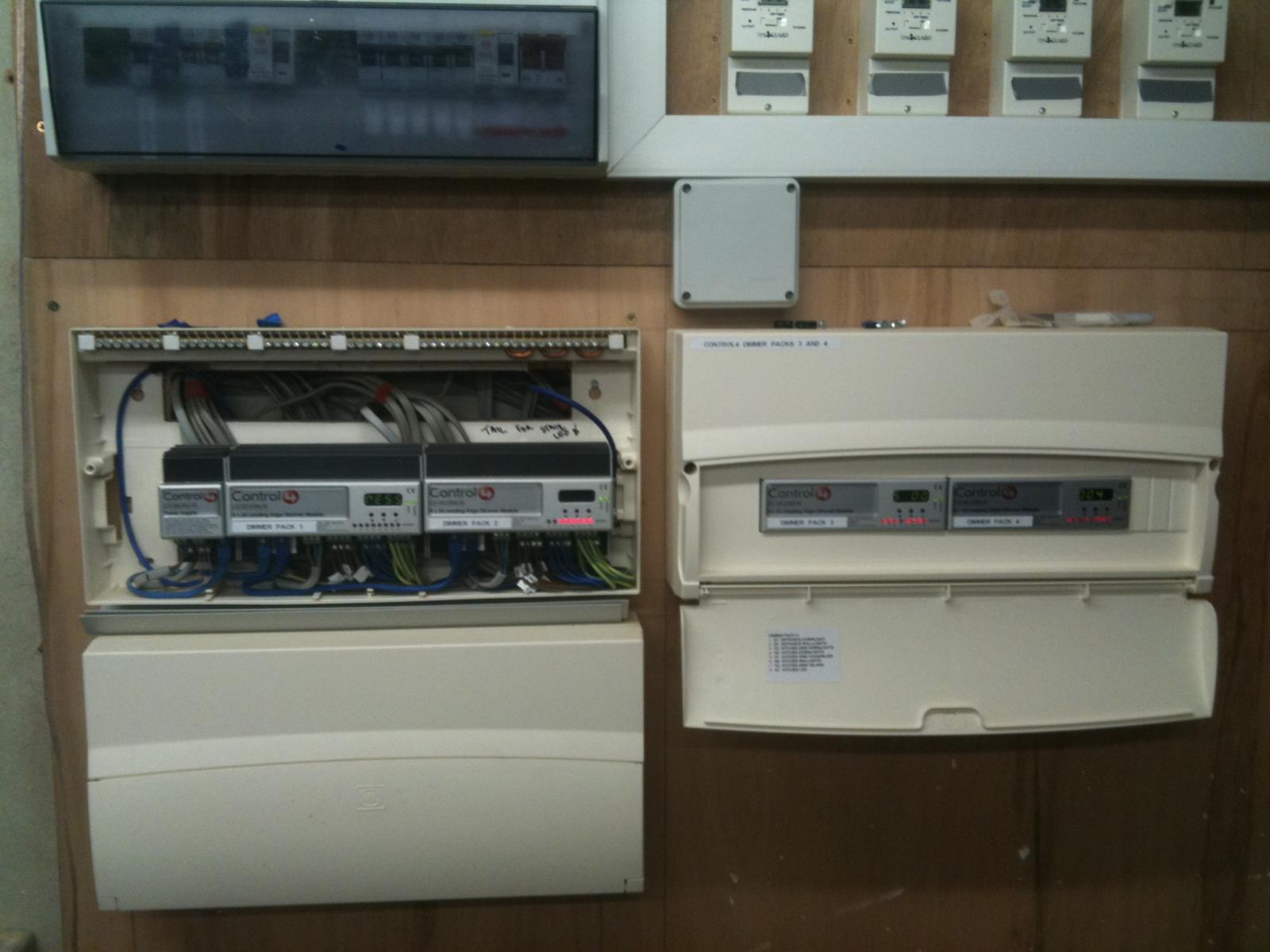

Had a look last night, and it's defo a strange one! Teletask. And as well as doing lighting control via banked dimmers (like a Lutron), it also switches power circuits via banks of contactors. So he wants each room in the house wired as a radial back to two 'heavily modified' Hager boards which will have to contain a contactor (with upstream RCBO) per circuit, then a large number of RCBO's per every light fed from a dimmer.....then all the CAT5 termination and control side of life....gonna be a crowded couple of boards!!
Hi mate it sounds like a control 4 or Rako system. I fit one early last year in a rather large house in Leeds, however I could be wrong as we didn't use Cat5 for the lighting. It could be that he has seen this idea somewhere on an install (where there are large amounts of data as well) and confused the two.
With the Control 4 system all the dimmer modules are Din Rail mountable so I usually buy a few empty consumer housings and connect into them.
On this install I just wired 1.0mm T&E from every lighting circuit back to the consumer/dimmer position (lots of wire as you are effectivly taking every switch wire back to a central switching location albeit remote controlled) and looped off this main switch wire as normal to all lights on that circuit.
What happens then is the client can buy custom wireless switches or install control 4 software on a ipad/iphone etc and control it. When you select a room and or scene it sends a signal to the main reciever by the dimmer module panel and turns on the required circuit.
Control 4 is superb in the fact you can have as many different lighting presents for example, the customer can press one button ready to watch a film, the Control 4 senses this and dims the lights in the main lounge, turns on a couple of lamps and then illuminates some LED's you have fitted to lead the way into the kitchen for popcorn. You can even purchase modules so he could control central heating/electric curtain motors etc
Another great thing was I put all his outside lights on this system and he never had to set a timer, the system would wirelessly connect to the internet and download the sunrise and sunset times everyday via a global clock.
I will have a look for some pictures to show you.
