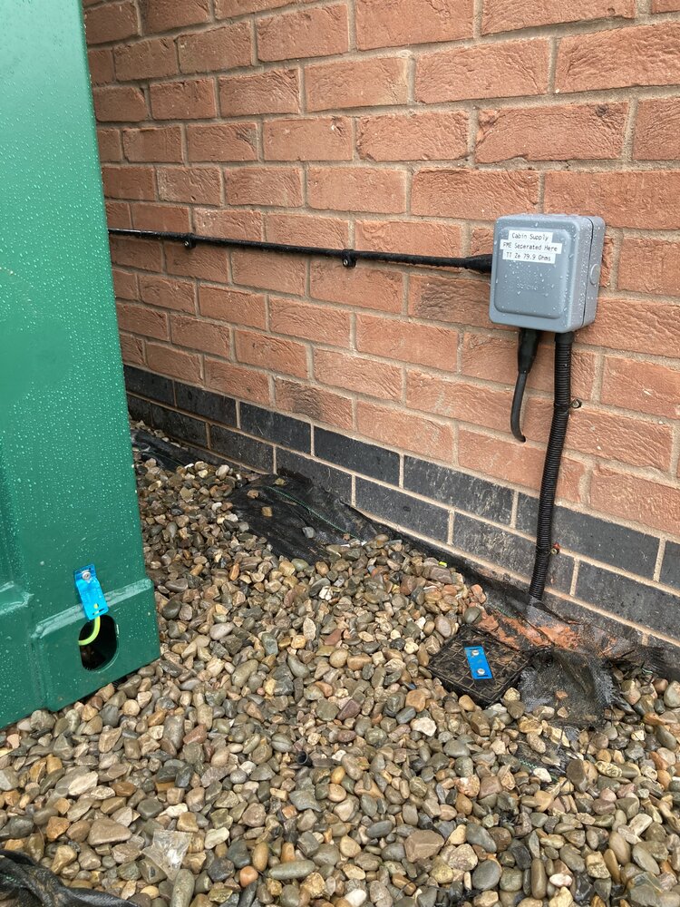

Well today is a very wet day and I’m doing the cabin today so I will IR test between the metal work and container and let you know the results. I will bond it anyway as it’s that easy to do and knowing the numptys round here someone will cock something up adding something in.
Cabin went closer than expected. Tested at 26kOhms in the damp so probably extraneous in heavy rain ?. Bonded it anyway, only took 10 minutes
[automerge]1600863908[/automerge]
Probably get slammed here for not putting the bond in a conduit box ?

Interesting. I however wouldn’t have a chance to get a cable back to the MET, hence why I tapped off the bin store light.
In an ideal world I would have brought over a dedicated circuit with a small CU inside the cabin itself.
