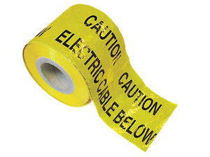

Reg 522.6.204 (iv) mechanical protection.
PS, but the Sunday afternoon DIY'er, won't let a 3mm steel plate stop them from putting up a shelf!
Maybe suggest a nice dado rail of this stuff?
Sorry, feeling cheeky this arvo ...
