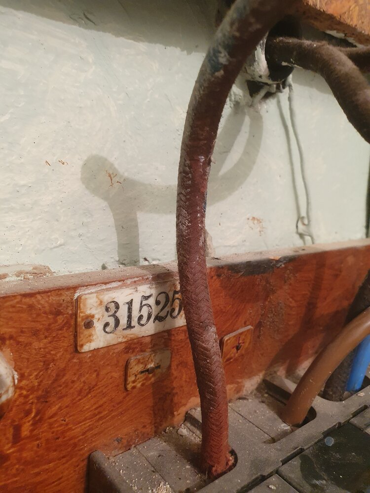

One of my landlords has an upstairs maisonette which will be changing tenants next week so will need an EICR - I already know there is an issue from a while back which I notified to landlord with a damaged 'Fuse Head'
This is how it used to be ?‍♂️ (Yes, live parts were under the "insulation" tape :eek:

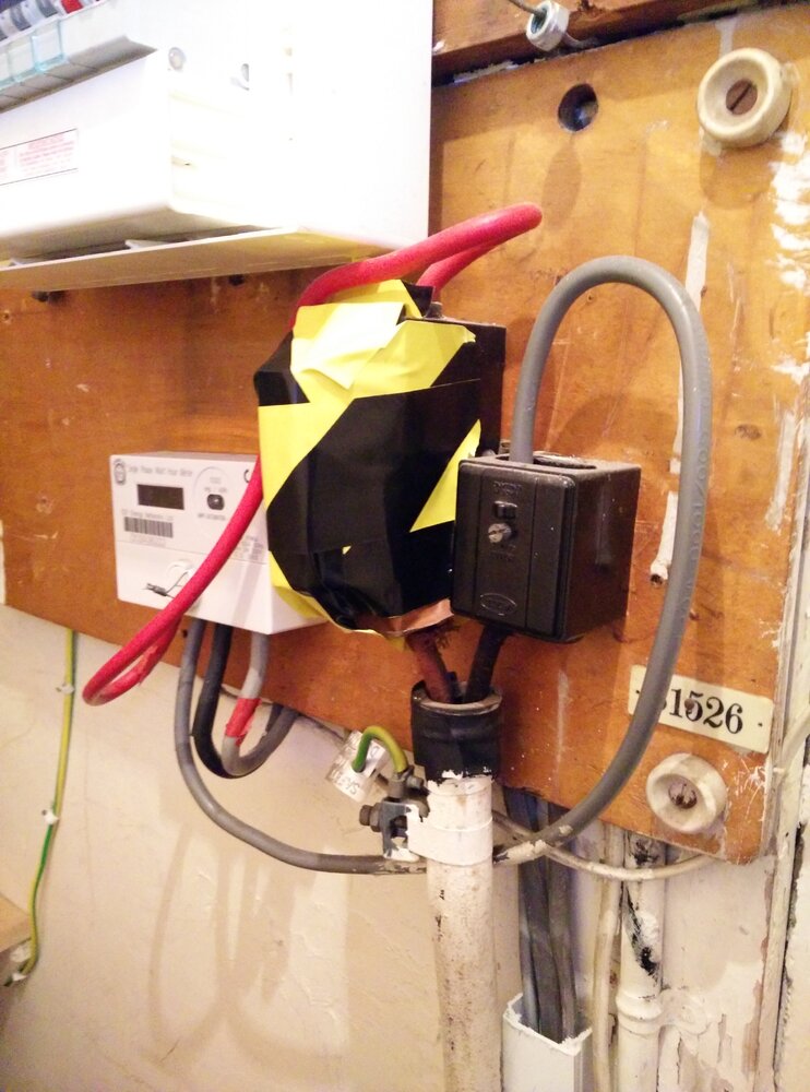

So I made good best I could on a previous visit and notified the DNO on the day who were due to attend that night.
I notified the landlord in writing and left it there - but have now found out that the DNO came to look at it and claimed it was not their responsibility.
Since it's prior to the meter, surely it has to be their responsibility? If not, then who's is it?

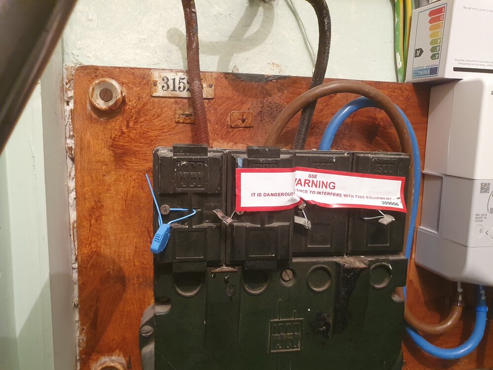

Anyway, I managed to pop into the lower flat today to have a look.
It's a split dual fuse head from a TNS incoming wire - the old tails go into a pipe in the wall up to the upper maisonette. A fuse head was then installed there, possibly because of distances of tails, (The tails might just be about 3m)
Anyone want to date the tails? No obvious sign of deterioration along the length, but fraying a bit where they leave the downstairs fuse...

I'll try ringing the DNO tomorrow, but since the item in question is before the meter, how would you deal with it? Seems a bit daft to put in a new fused switch there, for the small run to the CU, but I'm also wary of touching the cable pre-meter without something agreed to cover me against claims of meter fiddling.
Pass through Henley Block might be the best option to at least make it safe for now, but future meter installers might well look at that dubiously...

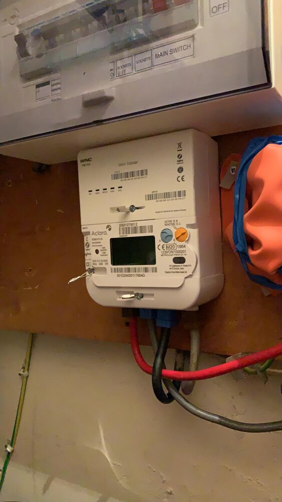

And now I find out that apparently they had a smart meter installed in August - which the landlord didn't know about ?‍♂️ - So he clearly thought it was 'safe'.

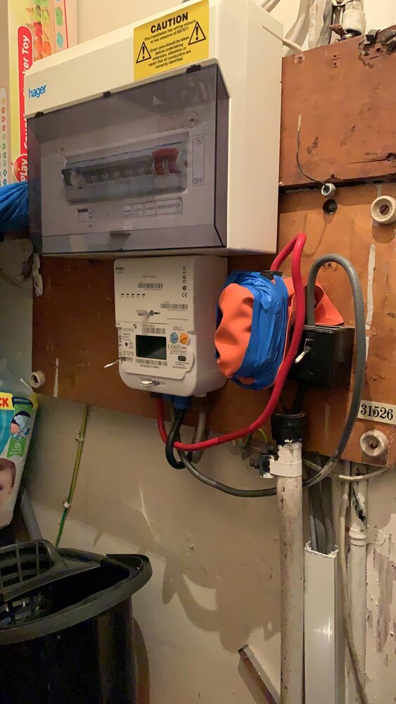

And behold - what the DNO person apparently did to improve the situation:
So what do I put on the EICR? FI perhaps - but they wouldn't book another job to look at it since the previous one found it was not theirs, even though they all accept its before the energy supplier's meter!
Best they could suggest was getting the downstairs owner to ring 105 and get a safety check on the cables from her end....
Starting to think maybe just putting a Wylex isolator at the top of the riser is the easiest option - that way when the board is changed it will make things easier, and if they do deign to replace their cabling, then they can connect to it directly.
Any guesses on the size of that riser pipe? Very tight with the two existing cables, so I'm not sure 16mm modern tails would comply with BS7671 re conduit spacing, etc. if I wanted to do them myself anyway.

Love how everyone who visits just adds some different colour tape on top of the existing!
Is 'Orange plastic' an approved method I wasn't aware of?
Looks like an old woopy cushion taped over it ?
I was wondering what it reminded me of!
Only seen a picture so far - will investigate on Friday but I assume it's something they carry on the van as usual and not just whatever he had in his pocket at the time.....
