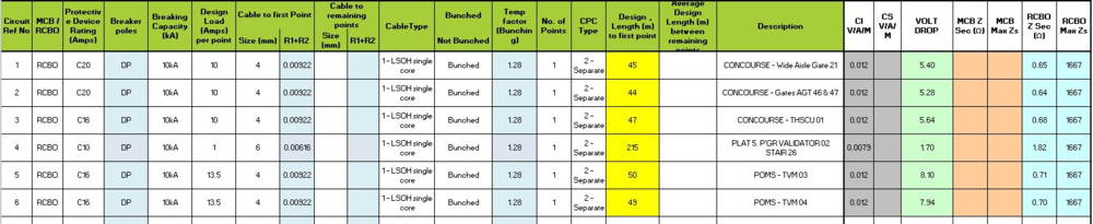

I have a concern with volt drop and Zs.
Could someone confirm that this is correct as i am not getting this output and i am not happy with it.
