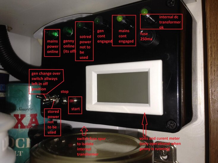

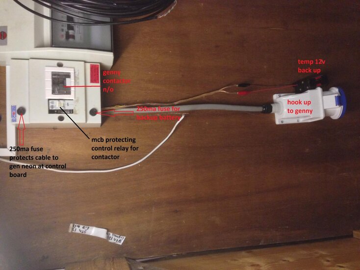

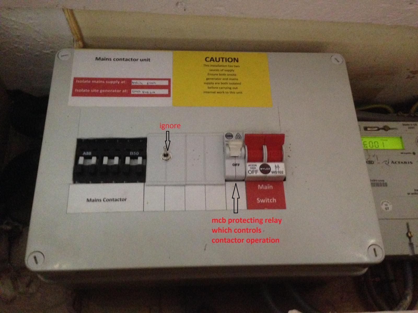

hi i have a thread under noisy contactor and said i would put annother thread up relating to a side subject from that thread
(please do not reply untill this part in the brackets is deleted just got the original design up for now not got enough time to show the changes that will be made from the knowlege i learnt in my previous thread shall get the second part of up tomorrow then remove this section in brackets many thanks bernie)
original system (scrapped looking for new ideas)
** Ignore this bit the idea has been scrapped I'm looking for new ideas, toward the end of the thread (page2) **
note: not in operation genny has not been connect nor will be conneted untill everything is complete
the genny has a output of 6.5kva
here is the original version i first put together
1) its a two contactor system both n/o
2) each contactor has its own control relay (2a 250v contact double pole, 12v dc coil with internal diode)
3) the main change over relay is a double pole double throw (two way) and the n/c connection (when the relay is dead) goes to the mains contactor control relay and the coil (230v) is energised when the genney is powered up and switched on at the main unit (switch is 250v rated) thus turning off the relay controling the mains contactor and energising the genny contactor control relay then engageing the contactor
4) both contactors has its own lumination on the main unit to tell the user if its engaged
5) the main unit has a lumination to tell the internal dc transformer is working
6) volt and amp meter telles user how much current is being used and the voltage out put (so i can work out how much power is being used and how much surplus there is)
7) everything is fused to protect the circuit
8) start and stop button for remote start and stop (when the genny has a auto choke and starter motor installed)
images below:
Well there is no way you can provide a mechanical interlock on what you have there!!
If you're determined to include a Generator into your mains system, then be wise and purchase a made for purpose Transfer/changeover switch either manually operated or automatic...
What is the make/model of the generator you intend to use for this installation, and does it incorporate a decent AVR on the alternators output??

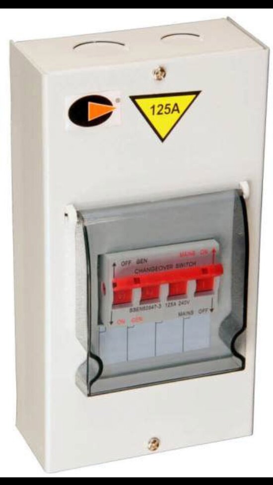

Well I'm just going to scrap the lot and go back to basics (no pun intended)
below is a picture of a basics changeover switch generator transfer 125a single phase metal clad m125cs (that's how it's advertised) will that be ok?
And later ill put the model number of the generator I have and ask if that's ok to use

Hi,
Surely you can get hold of an Automatic Change-Over switch, then your parents can sit back in comfort and let the little magic box do its business.
Regards.
I can see a number of worrying things there. But let's start with that connector marked 'hook up to genny'. Am I going blind or is that a socket-outlet? Please correct me if I am not seeing it for what it is...
And another thing that's actually more dangerous, do I see the tops of the contactors accessible from outside the enclosures, so anybody could (intentionally or accidentally) press the manual operation button and cross-connect the two sources?
Perhaps I had better not look any more...
It's a 32 amp three pin socket (like on a caravan)
but I have scrapped the idea now so it's redundant and will be removed
So you had a plug connected to a source of energy. With apologies for the pun, I recommend you pull the plug on this project and have a commercial transfer switch fitted. It really isn't worth the (many) risks you are taking with the present setup, due to lack of familiarity with the requirements.
