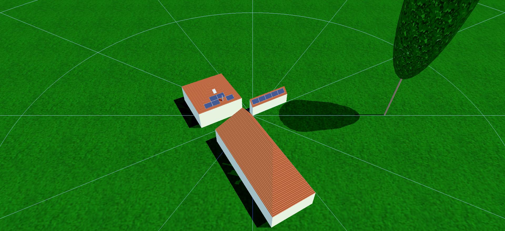

Hi Guys
At a job today and quite a lot of shading with a chimney on the middle of roof and a big tree. I'v created a model on PV Sol and from that calculated the overall shading. Thinking I would use a Solar edge Inverter. The following is a series of images that show the modelling and the shading. Looking for comments on the logic of my final calcs.
First Image shows the house with panels on the south west aspect and the garage on the same (Dorma on rear of house not on model)

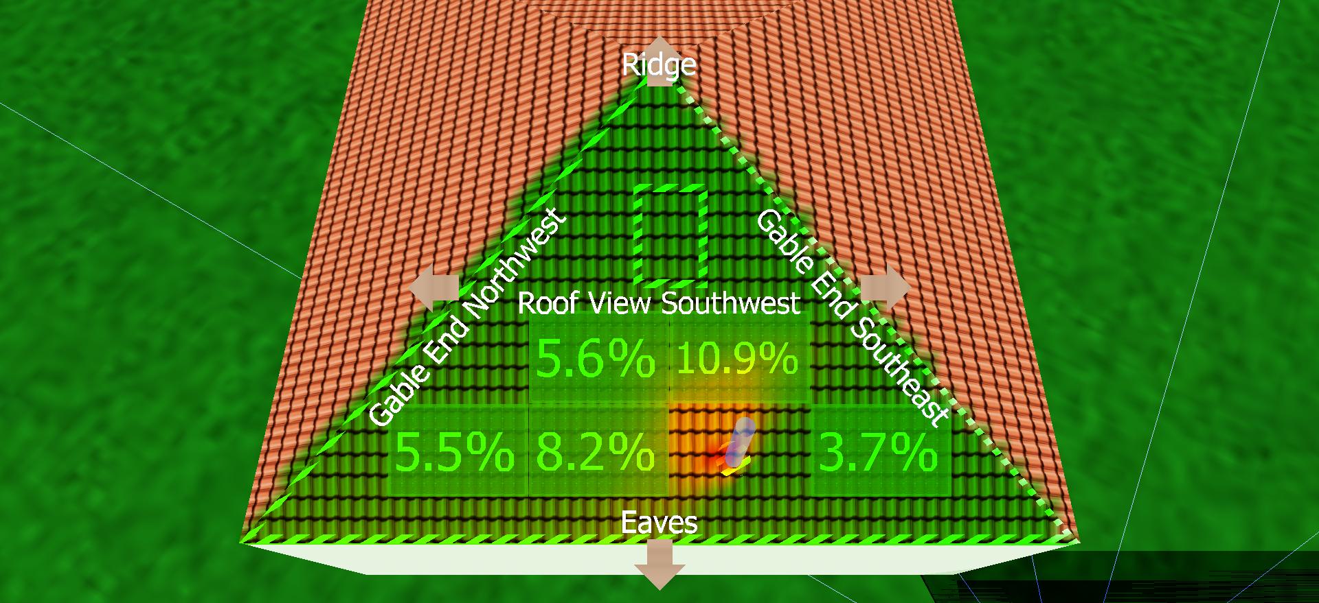

Second Image shows the House roof shading analysys caused by the chimney tree and probably house next door to a lesser extent.
Third image Shows shading on garage mostly caused by tree.
And the table below takes all of the panels shading and then because there is individual optimisers on each panel I divide the shading by 10 (the total number of panels:

Sorry guys, I just thought that if someone was experienced in using this system they would be able to confirm if the logic of my calcs was sound or not.
I have taken a simplistic view that if a panel is shaded by 10% then because every panel has its own inverter the panel would be unaffected by anything else and would therefore produce 90% of the time.
So my basic calculation simply takes this theory forward for each panel and adds them altogether to get a total. Simple.

Actually got a very quick response fro Solar Edge who have confirmed my cals with the following reply:
"Using a standard inverter wouldprobably deem this system uneconomic because there
would be a degree of shading on oneor more panel for a large part of the day and shading
on one panel brings every otherpanel down to the lowest output level.
Using Solar Edge technology everypanel has its own optimiser which means only the panel
that is shaded has lower outputwhilst all other un-shaded panels will produce maximum
results."
"all other un-shaded panels will produce maximum results"
