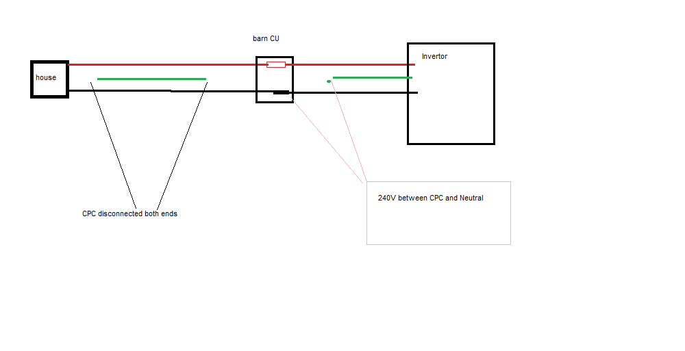

I wonder if someone with more experience of PV might be able to give me some advise.
Was called out today to a domestic building with a remote barn on which a 4kW PV array is sited. The Inverter is in the barn and a long (50m) 2.5mm twin and earth in pipe (historic) feed back to the house.
The problem I have is that there is a full short (L-E) on the cable between the house and the barn. So far no problem.
Just to prove the diagnosis I disconnected the earth at both ends of the cable between the house and the barn and re-energised the system
However I was then getting an Off Grid notification on the inverter and more worryingly 240V present when testing between N-E on from the PV inverter.
Is this energised CPC normal? And would the lack of an earth be picked up by the PV system and cause the OFF GRID notification.
The supply cable I can sort, just need to know if I need to call in a PV company to sort the PV Array out.
Thanks for any help
