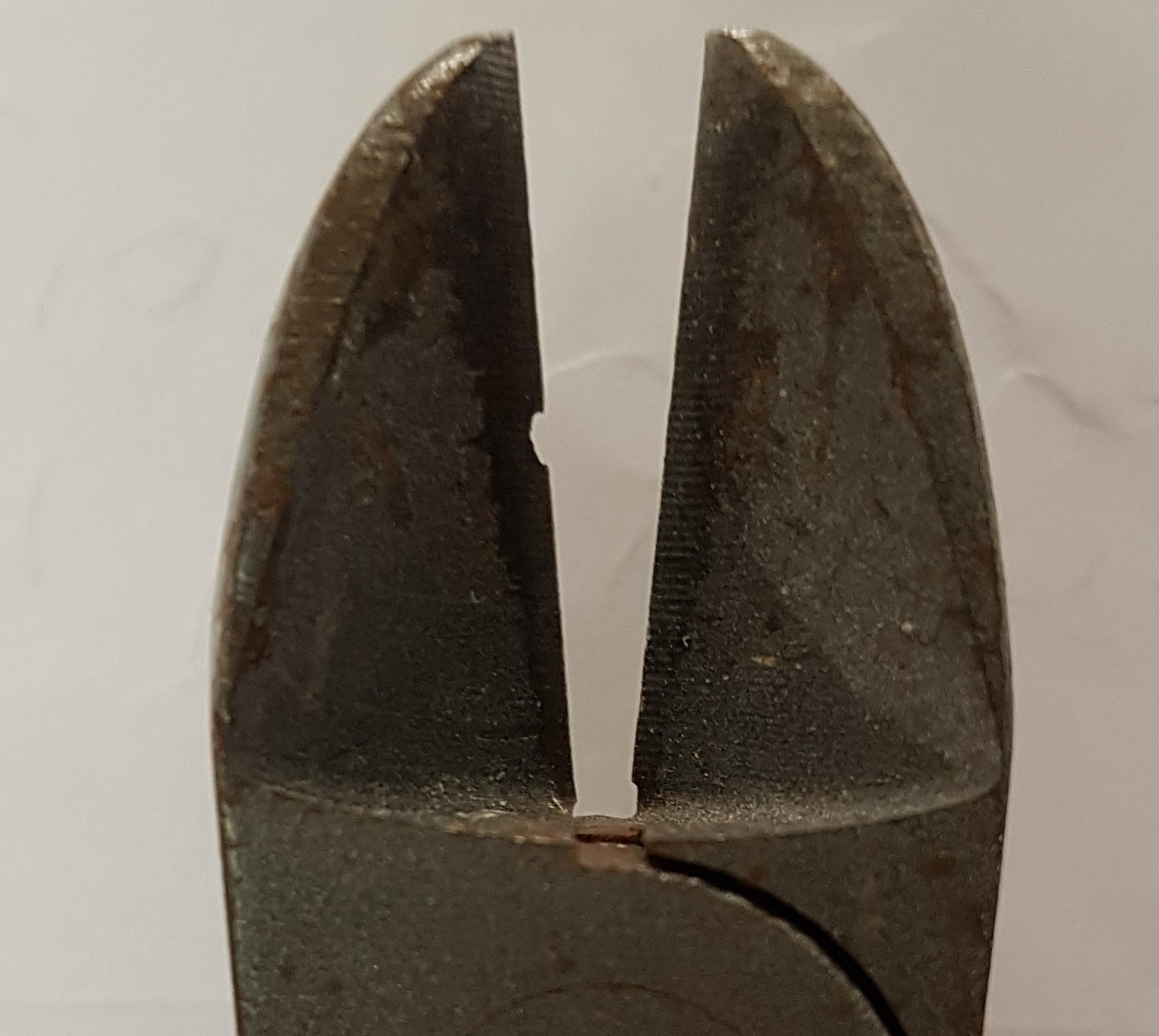

I realise these pictures aren't as spectacular as the others but they do show how powerful 230V can be. Plus it's a very real outcome if safe isolation isn't adhered to.
If a L-N or L-E short at 230v can take even a little chunk out of steel alloy, hardened with vanadium, then I hate to think what it would do to a persons hand/arm holding a pair of non VDE pliers.
These are my (now spare) side cutters after I cut through a live cable some years ago (whilst my mind was busy elsewhere, thinking about a difficult relationship with a gorgeous yet crazy woman.). We must keep our minds on the job!

I have a pair of those wire strippers.
They started life as a £45 PAIR OF Klein side cutters and lasted about an hour and forty-five minutes.
I bought them off a trade counter while I was picking up a length of MT2 to stick an extra socket in an office.
The existing trunking ran just below the ceiling so it was an easy case of pulling a leg out of one socket, dropping it into the new and running a new leg back to the old socket.
What could possibly go wrong?
So pulled out my virgin side cutters out to cut out a notch for the new drop and.....bang.
Yep there was a 1.5 laying flat in the bottom of the trunking that I didn't see on account of not being attentive enough to get my lazy arse up and have a look.
In fairness to myself it was the flattest piece of cable I've ever seen, or not in this case, in trunking. It's like the spark ironed it.
Lessons were learnt and new procedures were put in place.
