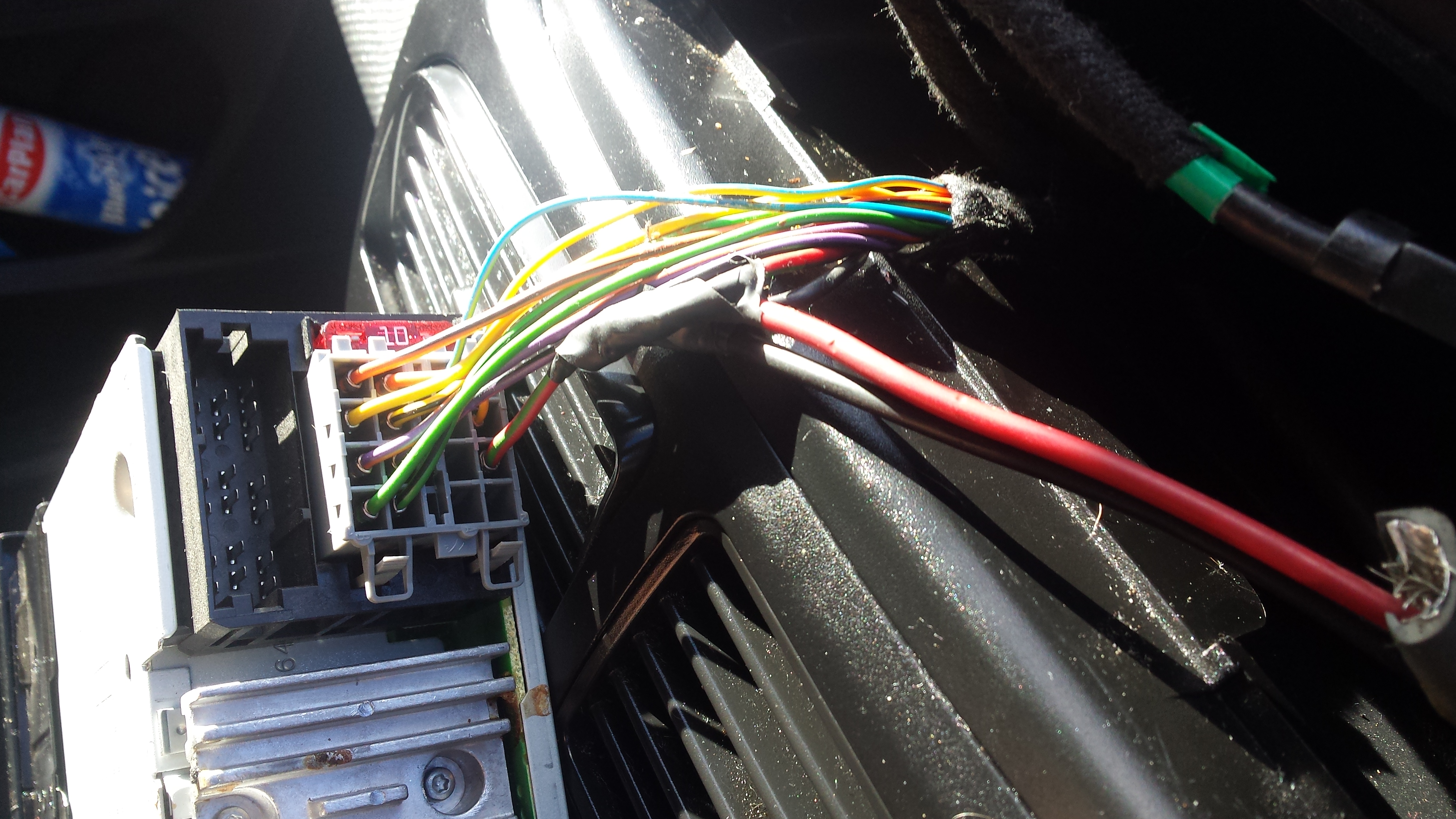

I'm trying to figure out why my new Fiat Doblo's radio doesn't turn on and off with the ignition. It seems there's only a permanent live provided to the radio, no ignition live - anyone with a Doblo confirm this?
Not familiar with the Doblo but the fiat 500 radio has a software option to stay on after the ignition is turned off and doors locked . (his stopped on 20 mins)
this option is accessed by the screen controls .
Reactions: hightower and Admin
Yeah, this doesn't have that option unfortunately. Ignoring the block of 8 wires on the left (speaker wires), the right block has:
Blue (Seems to go live with ignition) - wired in to a port marked +15
Black (Ground) - wired in the port marked GND
Yellow/Blue - controls the dim level on illumination, correctly wired
Red/Green (Permanent live) - wired in to a port marked BU
I'm thinking the Blue and the Red/Green need swapping - there's an ignition live after all but it's not doing anything to help matters the way it's currently wired. I've managed to get the Red/Green out the ISO block, but the blue is proving trickier. What's peoples thoughts? Swap them and see what happens?
Could be a goer - 7 on block A currently hosts the blue (ignition live), 4 hosts the red/green (perm live)
Fiat wiring and radios you usually haveto swap the red and yellow in the iso conector adaptor supplied ( the original colours of the fiat differ) with the after market radio if its an aftermarket radio you have hit the nail on the head. (it wont damage anything to try it either as long as you have the radio code) usually all that happens is you lose presets or radio dont turn off depending on model

It's not aftermarket, but my suspicions are it used to have an aftermarket and it was swapped for that, the original was put back in to sell the vehicle but the connections weren't swapped back. I'm not sure if I have the radio code, but I've already disconnected the connector block from the radio so too late to worry about that now. I'll give it a go anyway.
Reactions: Lou and Barry White
And bingo, managed to release the blue from the block, swapped them around and now the radio works in line with the ignition! Buzzing because that was quickly getting me irritated (getting half way out the van before realising the radio was still on)
Ok so radio turns off with the ignition now, but it's still a manual switch on. Also when I switch on now it goes to radio even if I last had it on cd. I'm guessing it's losing its memory. Any ideas what to try next?
