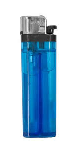

what do you guys use for a heat source i had a small gas flambeaux torch that i was using but that broke and needs replacing
Cheap electric heat gun (sold for paint stripping etc.), just have to a bit be careful if the heatshrink is being applied on the only circuit available to power the heat gun!
Reactions: 1 person
only reason i miss the ex-wife. she just had to breathe on it.
Reactions: 2 people
Antex gas cat soldering iron with the hot air attachment.
Reactions: 1 person
A controlled gas flame is always better than a heat gun for heat shrink, especially for the internal adhesive heat shrink material. For the small stuff that most of you will be using, a simple small gas canister type torch is all that's needed.
