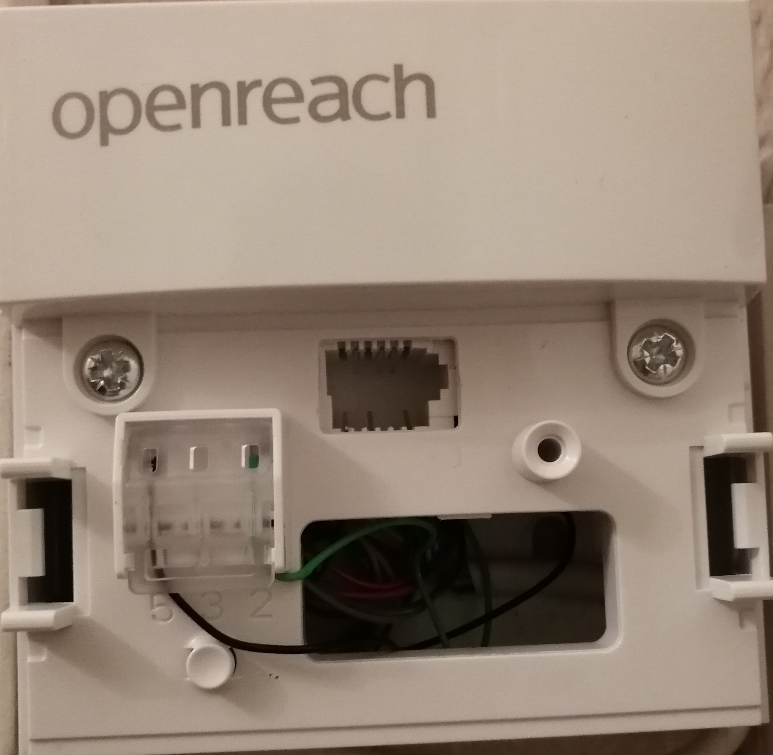

I put the green and black wire back into the 2 and 5 connection on the master socket faceplate and the extension 2 and 5 wires read 50.8V exactly.
When I put the green and black wires into the A and B on the faceplate the voltage on the extension 2 and 5 wires fluctuates a lot. It seems to mostly go up and down between about 15V and 25V, but also goes up to 40+V. It's not constant at all though.
Not sure what that means?
Would removing the ring wire (the green wire in terminal 3 I think?) make a difference (as mentioned below)? Or am I best to leave it where it is?
I'd say that means the Mk4 clip-on plate is fuggered!!
Whilst that may improve working broadband by a tiny fraction, yours isn't working at all yet. It shouldn't cause a total loss.

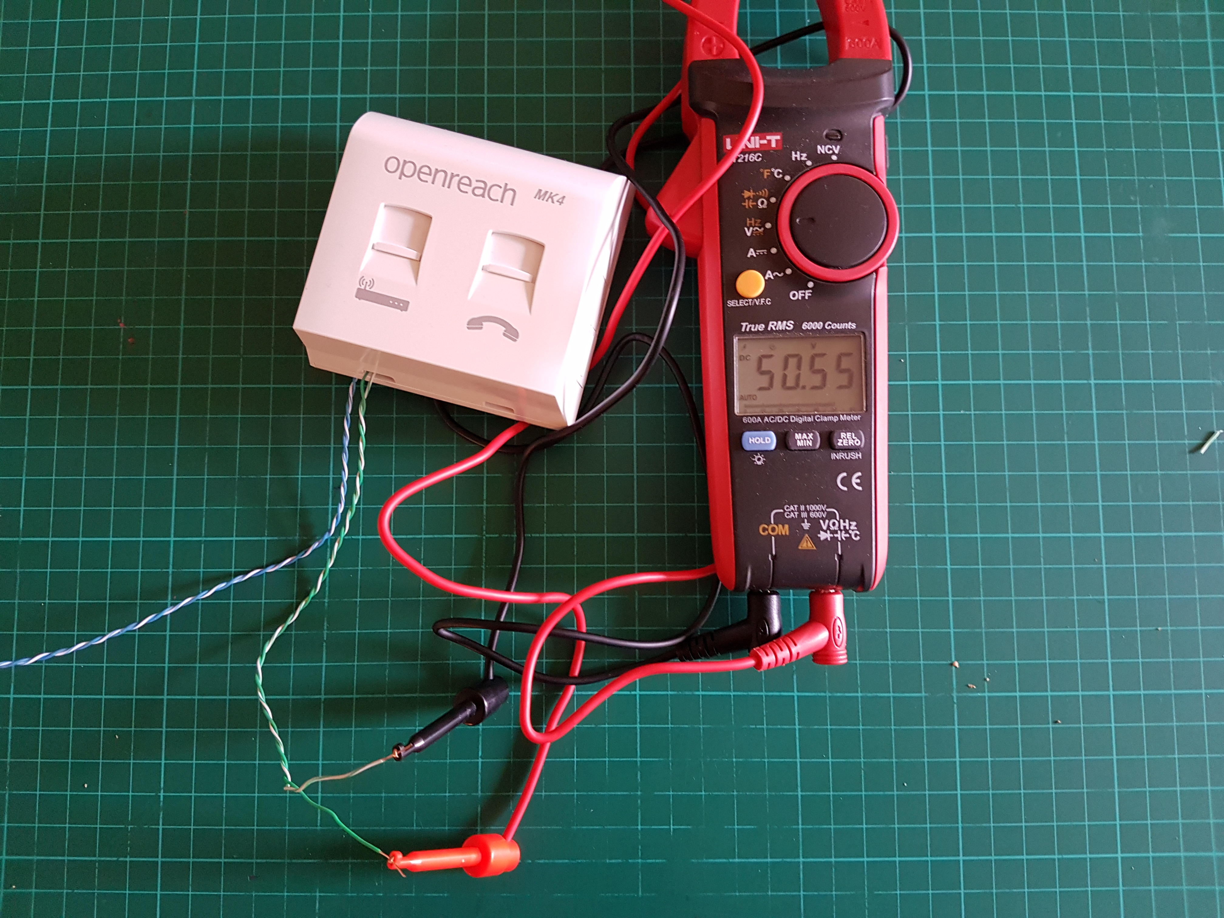

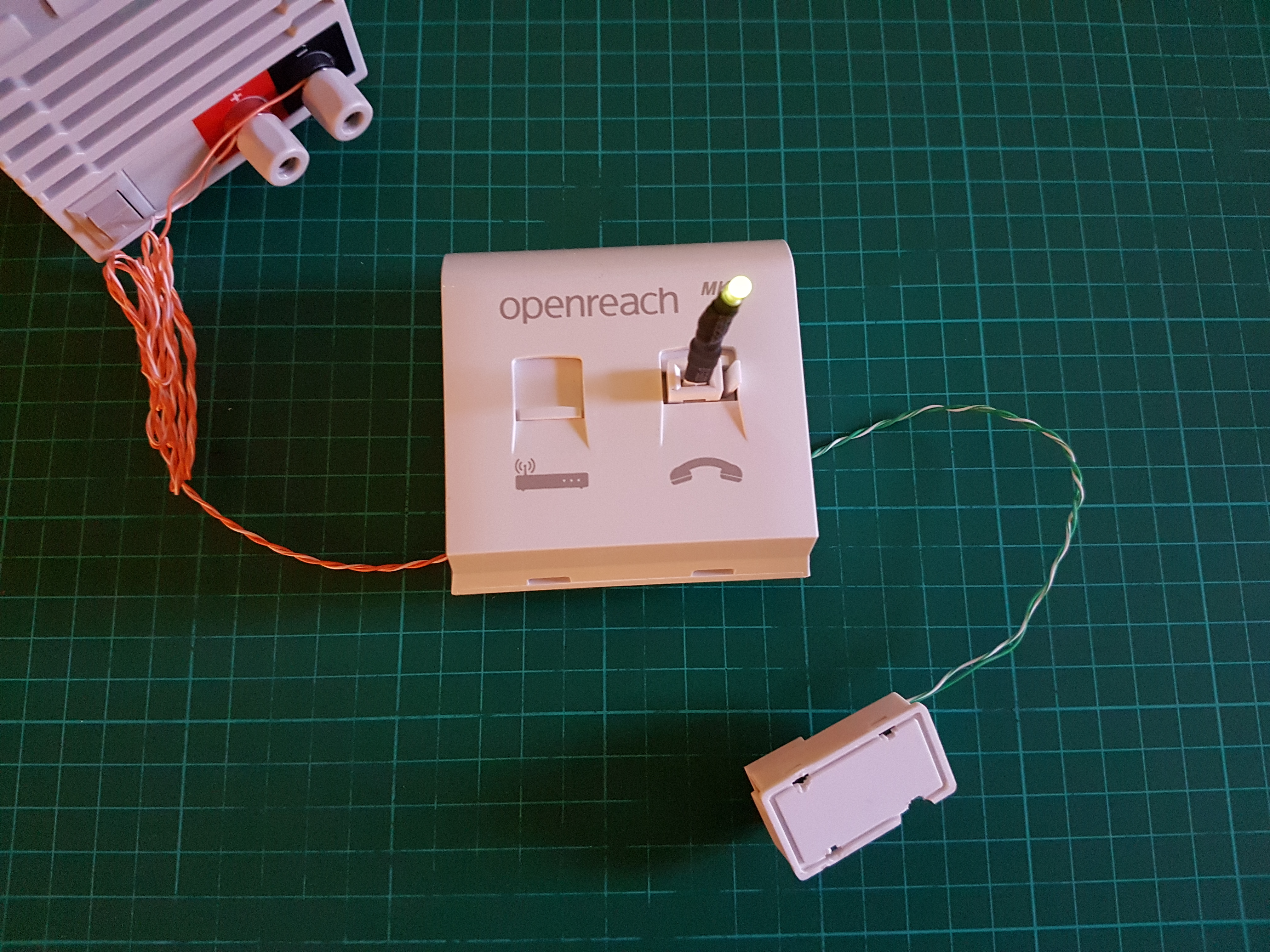

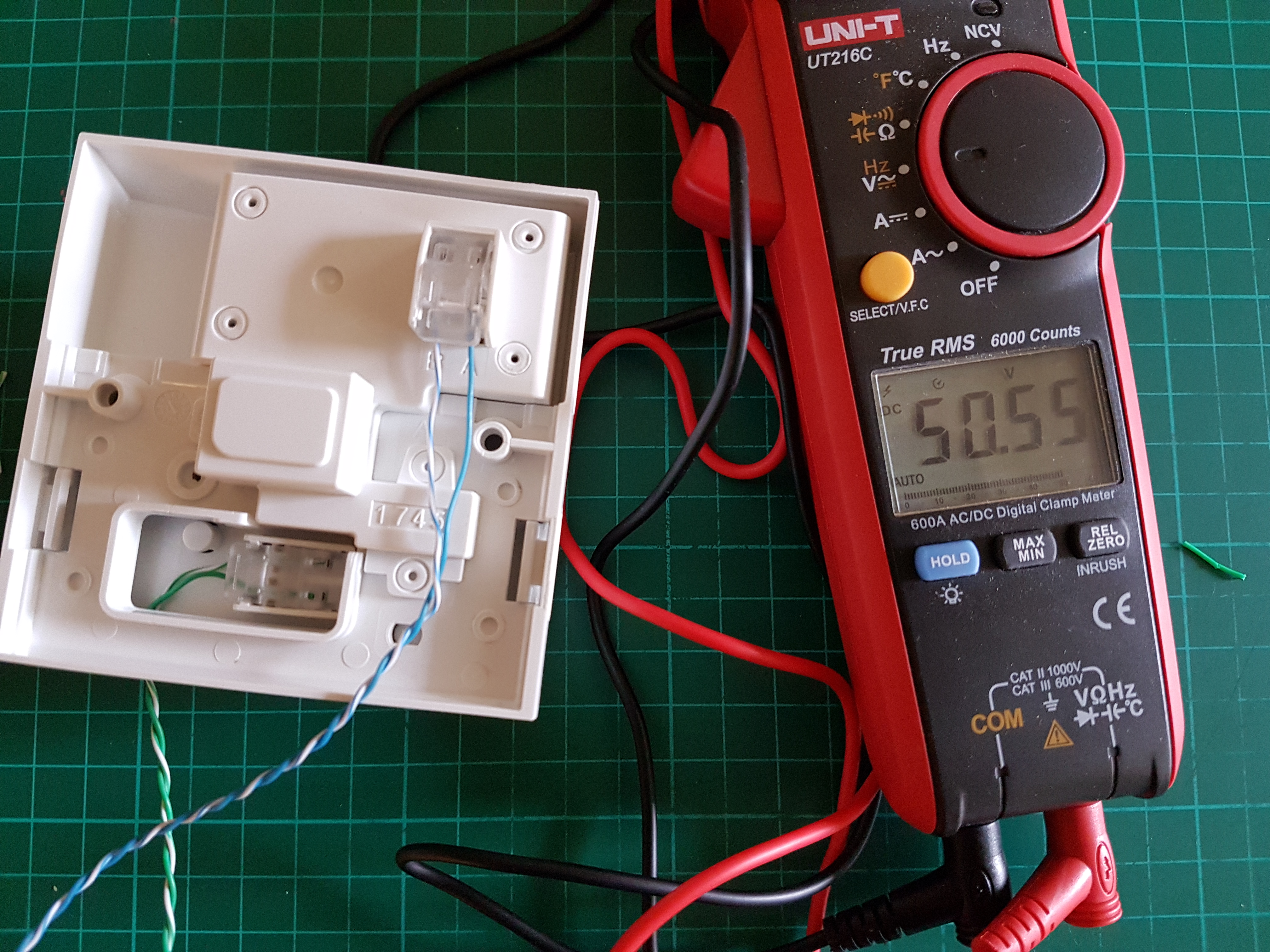

I just did an experiment for you. Incoming line(blue pair), no master socket at all, just a pure line measurement, 50.55v...
Secondly, 5C master and Mk4 plate, extension added through "2&5", same result...
And finally, extension added via "A & B" on the Mk4 plate. Still the same result, 50.55v...

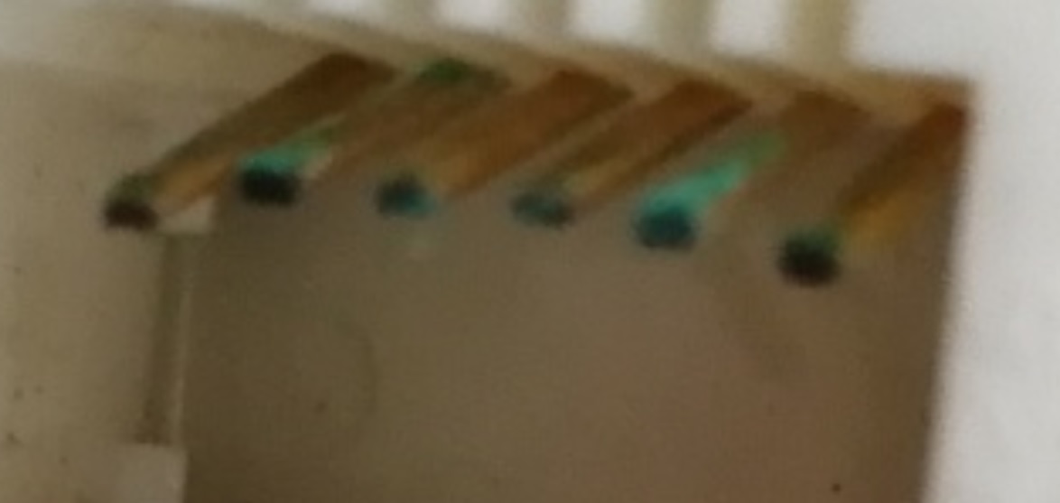

One additional point, I'd be a bit concerned by the corrosion on the pins inside the extension socket...
Not saying it's related to your issue, because your phone worked up there and measuring the fluctuating voltage was done in the IDC slots, not touching these.
BUT...
When you get the router working upstairs, if you get poor download speeds compared to before, or a connection that drops out now and then, it would certainly be worth swapping it for a new one. As you can see, it's pins 2 and 5 that are the worst and they're the only two that it uses! That could easily cause a high resistance joint and cause speed issues.

Yeah, that doesn't look too good!
I'll bear it in mind. Perhaps I'll look at changing it for a RJ11/RJ45 data socket anyway, seeing as it won't be used for a phone at all.
