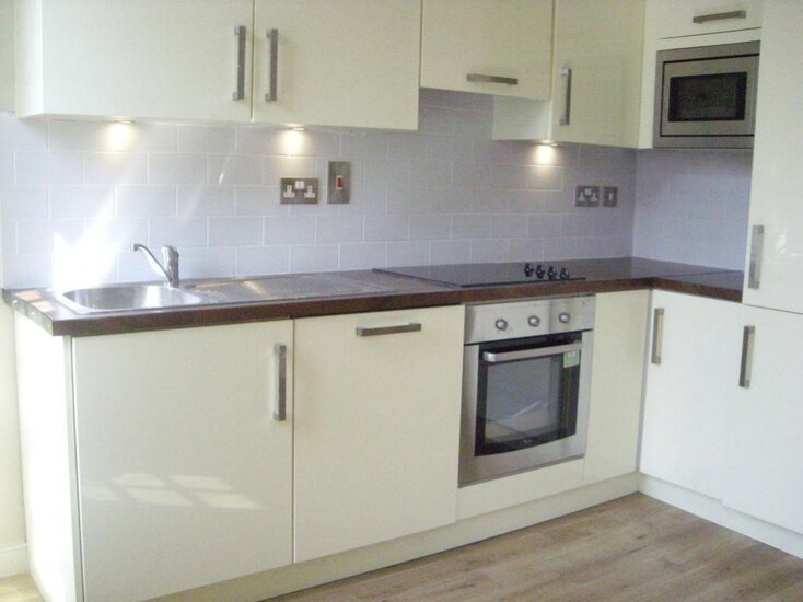

Although I am a trainee electrician I still work with refurbishments and my supervisor sent me to the companies other site to finish some work and this is what I found in the kitchen (see the picture)
is the installation correct?
i am not saying what I am suspicious about (I am not even 100% sure ) but I just wanna know your opinion and regs that apply to this installation

i guess you are asking about the socket near the sink i am taking it that the circuit is rcd'd its not ideal but its ok
No problem with that, a couple of things you could be asking, 1 is the socket as previously mentioned or it could be the switch close to the hob but its not behind it so no probs unless you can see anything else
I would suggest that your socket is too close to the sink but
BS 7671 is not prescriptive with respect to such distances, but the industry recommendation is that a distance of at least 300mm should be provided from the edge of the sink or draining board to the socket outlet. :)

do you mean the regulation about special location containing a bath or shower tells you to use an RCD in this situation as I cannot find anything clearly stating about the kitchen sink or it's just your experience that says that?

I agree with that and I found it in the book Electrician's Guide To The Building Regulations (page 61) [ame=http://www.amazon.co.uk/Electricians-Building-Regulations-Electrical-Dwellings/dp/086341463X]Electrician's Guide to the Building Regulations Approved Document P, Electrical Safety in Dwellings: Amazon.co.uk: Books[/ame]
but do you know any reg stating that you need to keep the equipment 300 mm away?
Ah, looking at the picture again I didnt realise the socket was above the draining board, personnaly I wouldn't install a socket there, not too much of a problem with the switch but its disputable
There is no reg with regard to the positioning of socket outlets with regard to sinks etc.
However, as already been mentioned, it is generally recommended that they should be installed around 300mm from the edge of the sink or be suitably rated for its location.
All socket outlets must now be protected by 30mA RCD, regardless of where they are installed or installation method.

As mentioned above numerous times the socket too close to the drainer (covered by external influences if you need to tie a reg' to it)
Switch for cooker poorly sighted as a hob fire could put this switch out of arms reach
Finally if the under unit lights are halogen then the one over the sink should be IP rated as im guessing it isnt if cold water was to splash on the glass the thermal shock could cause it to explode extremely hot quartz glass.:eek:
300mm rule comes from building regs and although not part of bs7671 is good practice where possible

The socket near the drainer is a consequence more of the design of the kitchen rather than an electricians poor siting of the accessory
It has room for an appliance and is not exactly going for a swim just yet :)
The only point with concern has already been mentioned by Darkwood, the possible unsuitability of the undercupboard light over the sink,but its probably ok

  • the sighting of a double socket over the drainer without any appreciable area of worktop to use is dumb. Makes me wonder why it put there.
  • There is no apparent (apologies old term abuse) switch fused spur controlling the dishwasher sited between cooker and sink. Totally naff siting of dishwasher ... bound to get in the way.

Oh also something else i just spotted.. How high are those electrical points (says sarcastically) !!!
No hidding of cables behind the appiances for them then.
Apart from the electrical spots previously mentioned there is a srious one on the fitment of cupboards above a cooker.
No cupboards should have a vertical face above the edge of the hob(extreme fire hazard.).
