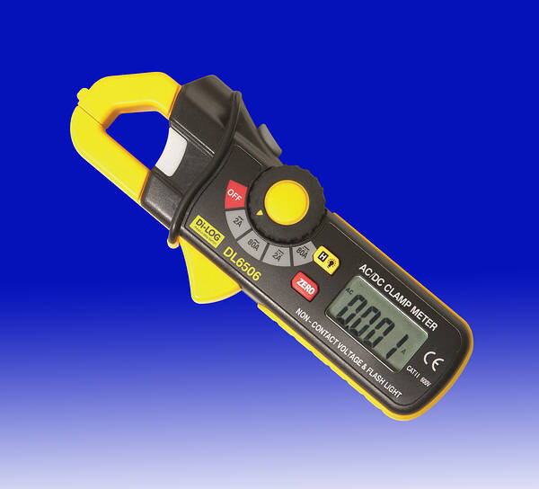

Hi - Don't mean to teach you how to suck eggs, but if you put a 10A meter in series with the battery it will likely be fried when you start the motor. You need the clip on sort that can measure DC amps. They look like this -

.... Most car currents (ignition coils / Jammed-electric windows ) will be too much for your 10A range ... (especially charging current !)
Yep,there are methods of using that Tandy meter,even with it's 10A safety valve:)but,too involved for explanation,here.
You really need a clamp or clip type,which will give you current magnitude and direction,and are available fairly cheaply. I have an ancient Durite clip-on,which was my go-to jobby,as a kid...
Thanks. Yeah, I wouldn't try to start it on a 10A meter! In the past I have put croc clips on the terminal and lead, then slid the lead off the terminal.
