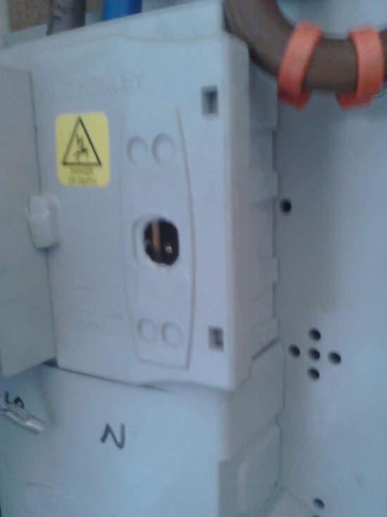

image01.jpg image2.jpgimage3.jpg hi its me again this is the photos,im hear to learn from the big boys ,

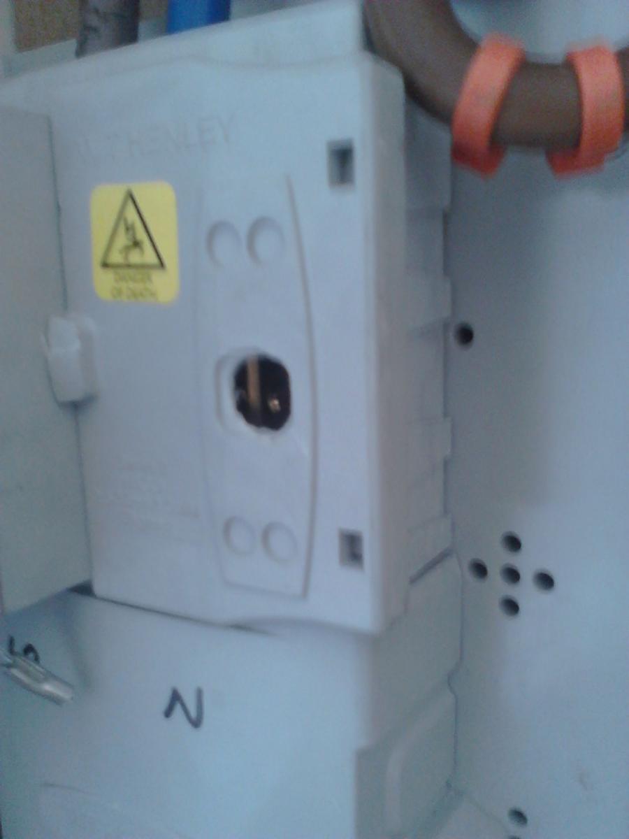

Piccie #3 looks a bit worrying ....... the isolator is in the ON position and there's a bit of green/yellow flapping in the breeze ............

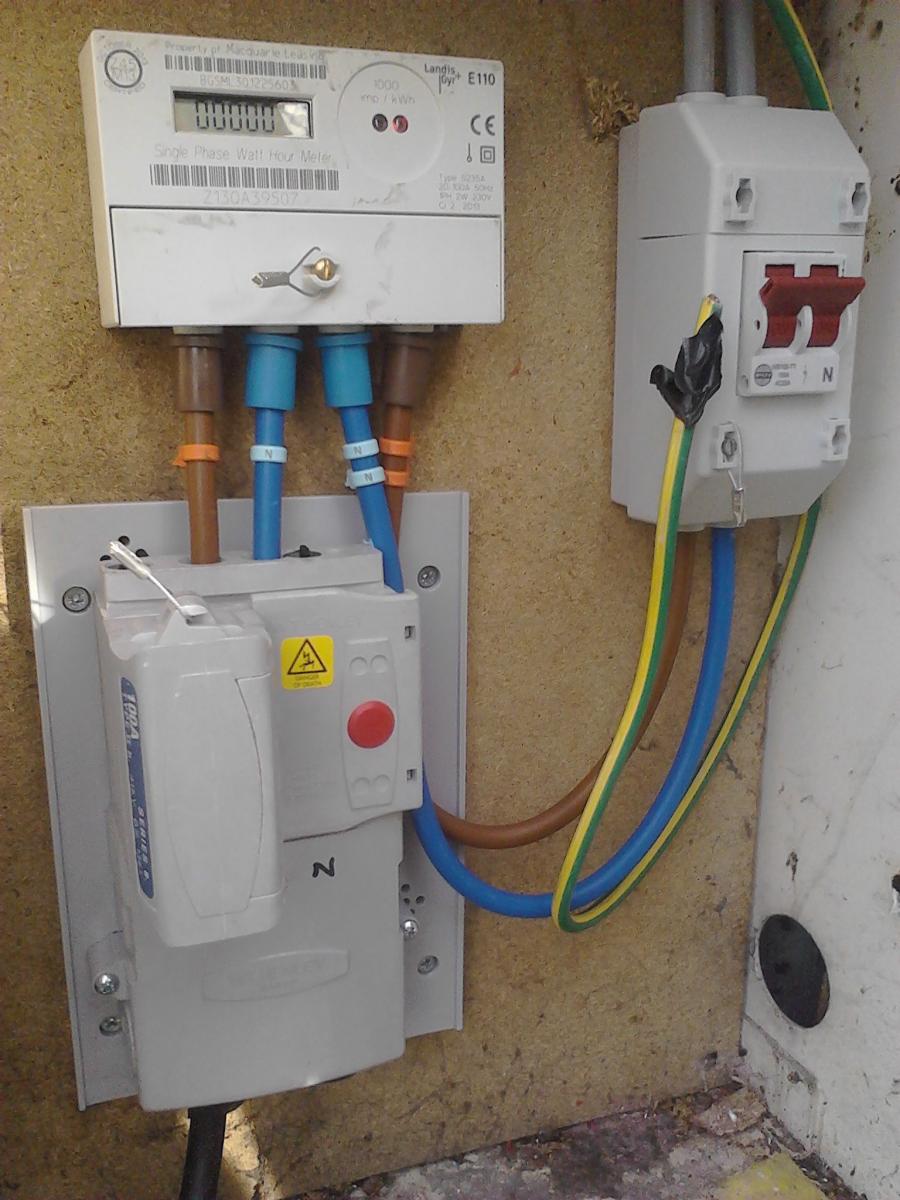

So you have wired a property without actually knowing what earthing arrangement is used? You could well have to change the whole DB if it is a TT.
Who connected the outgoing tails on the main switch provided by the DNO?

what system is this and how can i sort this,need some advice ,im askeing for your help ,im hear to learn from this site,yestarday you lot said bring photos and what now.
Did you phione the DNO and see if they could help?
looks like a TT to myself. But I could be wrong.

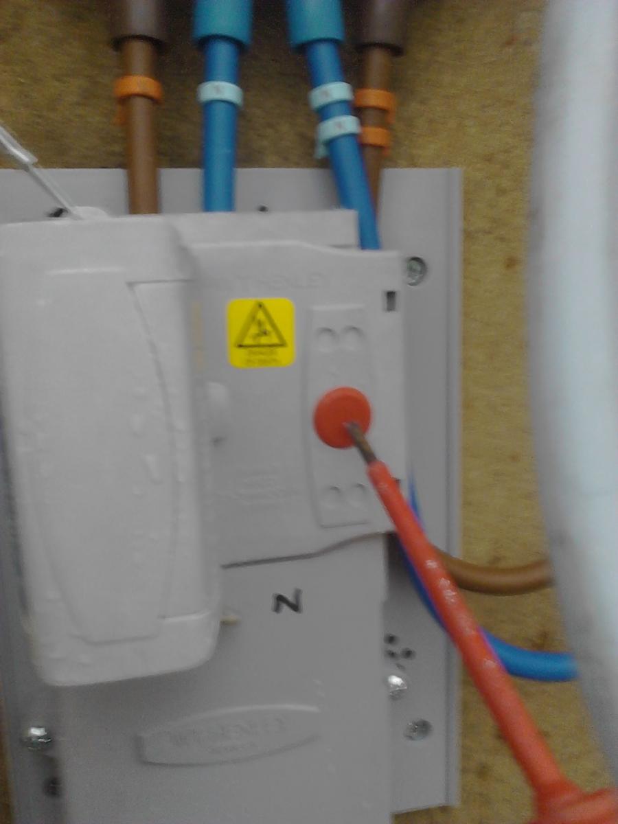

You'll be pleased to hear that the feeding the switch option looks like the one I'm going for so today I dug my Metrel MFT out and cleaned it up a bit. ... It still works!!

It's been a long day and I may be missing something here, but: In picture 3 there are tails feeding an isolator (switched on, as pointed out before), but you say it is feeding the switch shown in your more recent photo. Are there 2 isolators? Daz

so now you need DNO to come back and fit an earth terminal to connect to.
h iits me again ,NEVER GIVE UP IF YOU WANT TO LEARN,I phoned the supplyer and it is a PME SUPPLY,VoltzElectrical WAS 100% WRIGHT.SORRY AGAIN TO Geordie spark ,
We could have all said the same, however we wouldn't suggest it due to the fact attempting to connect an earth in that cut out without conformation would be dangerous situation, that's why we questioned you a lot about it.
