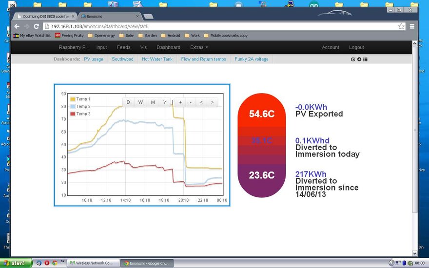

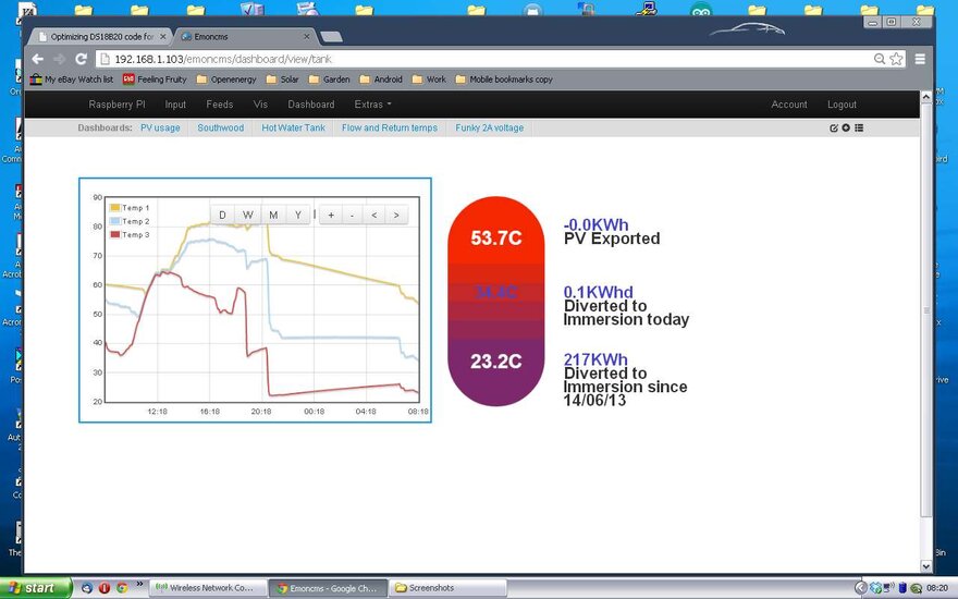

I fitted a 36" immersion and whole house TMV to my 150L tank and despite running at higher tank temps my system was still shutting off at around mid-day. Note the higher temps will give scale problems in hard water areas.
I looked at fitting a de-strat pump but found that fitting a second immersion (11") via essex flange to the bottom of the tank was a much easier and cheaper route in my case. Fitting the flange, although straight forward, is not something I'd recommend a diy'r try unless very competent.
I'm switching my home made diverter manually between the two immersions at the moment until I get the software to do it for me, but I think your unit could be set to change to the bottom immersion after the top immersion has been off for x-minutes.
With a de-strat pump during the winter you risk stirring the tank after heating the top of the tank when the sun is going down and ending up with a tank of luke warm water. With two immersions you will nearly always have the top of the tank hot enough for at least one bath in the winter and on good days the bottom immersion will increase that.
Despite my bottom immersion limiting at 65C instead of the 75C on the spec sheet it is still making a big contribution.
The attached graphs show two bath draws on the top immersion setup and two bath draws plus a next morning shower draw on the two immersion setup.
The temp sensors are located 8" from top, middle and 6" from bottom of my tank.
Reactions: 1 person

They are both quite large 7pm and 8pm bath draws but they look very different due to the different temp distributions at the start of the first bath. Only the top and btm immersion graph shows the much lower draw from a shower at about 7:45am.

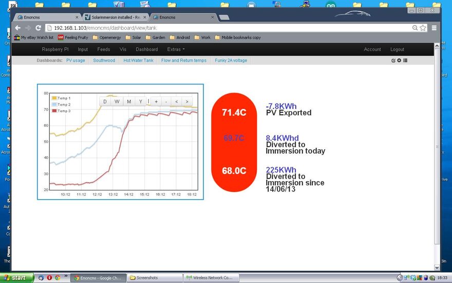

Here is another graph screenshot taken a few minutes ago. It shows the tank heated on the top immersion until 12am and then switched to the bottom immersion. I am now going to switch it back to the top to use the remaining sun to top up the top of the tank. Note that it has been limiting since about 3pm even on the btm immersion
