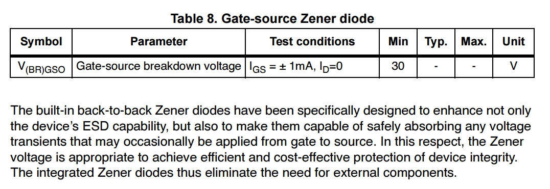

I want to protect a MOS FET for ESD with a bidirectional TVS diode. The MOS FET I have has not a built-in TVS diode. The max gate-source voltage (Vds) is 30V. Shall I chose a TVS diode that has a clamping voltage (Vcl) exactly 30V or to be on the safe side a little under like 27V?

The clamping voltage should be higher than the normal operating voltage of the signal line, but low enough to protect the MOSFET.

I understand that. But since the max gate-source is 30V, over that the MOS FET can fail so the clamping voltage must be a little under 30V in order to protect it. I don't know the operation voltage but I suspect it's significant under 30V.

Another MOS FET I have has a built-in TVS diode for EMD protection. This MOS FET has also max 30V gate-source. But the built-in TVS has Breakdown voltage (Vbr) at 30V. So the Vcl must be a couple of more volts. Strange. Vbr is when the diode begins to conduct. And Vcl when it conduct fully. See table below. You might think that the built-in TVS should have Vcl at 30V in order to protect the MOS FET?

What is the trigger voltage if it’s something like 10 volts then a 15 volt diode would do
