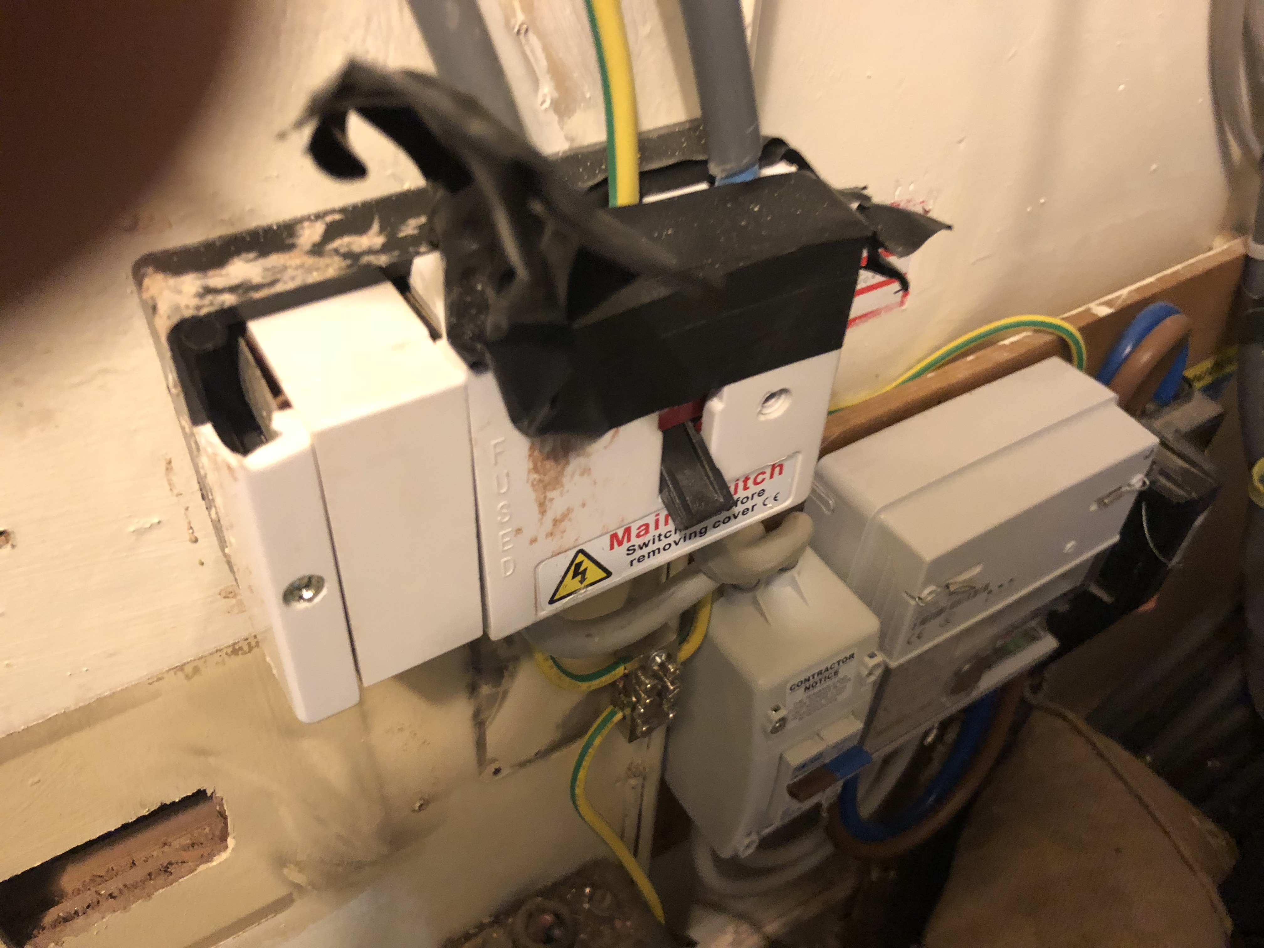

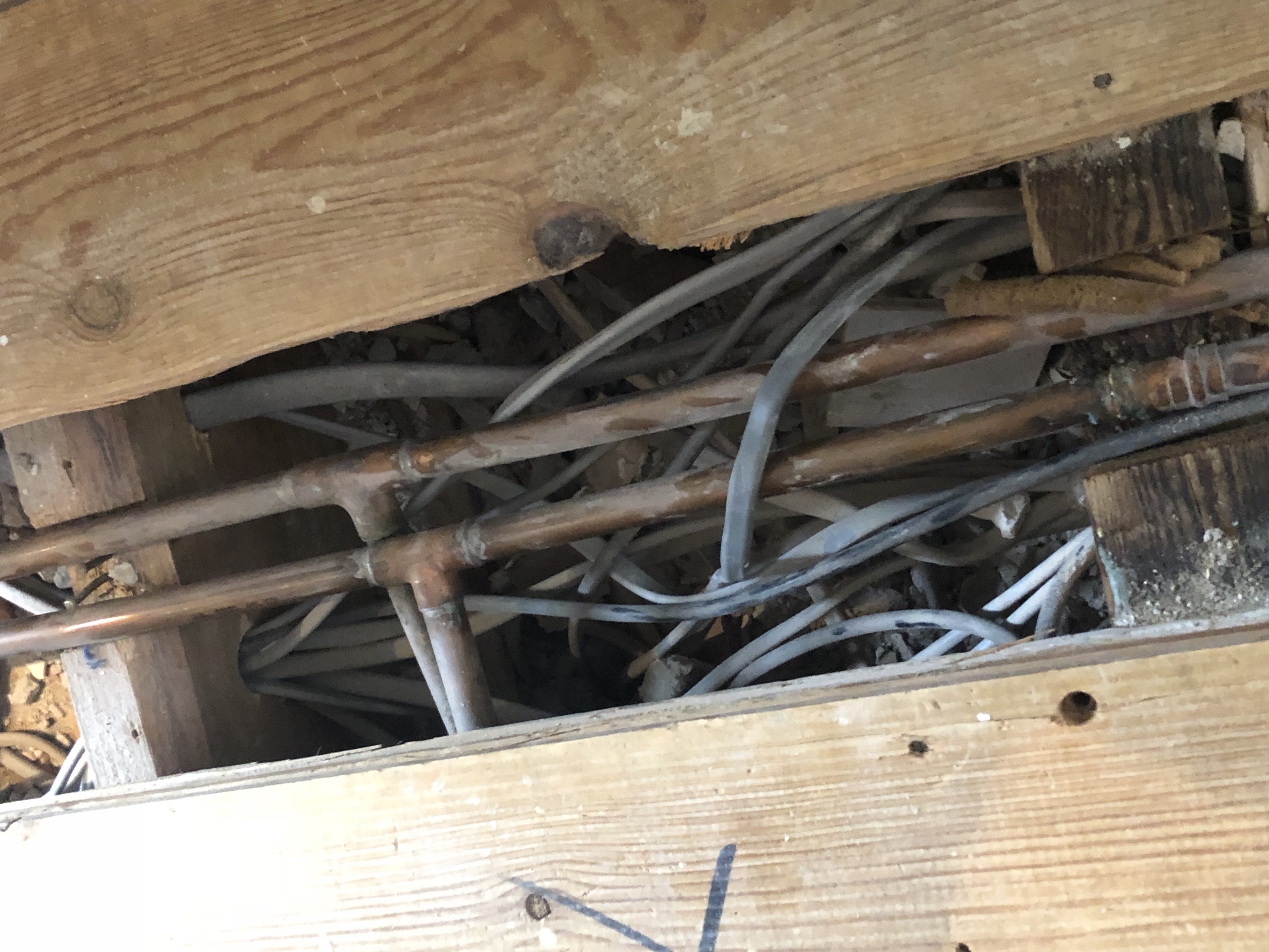

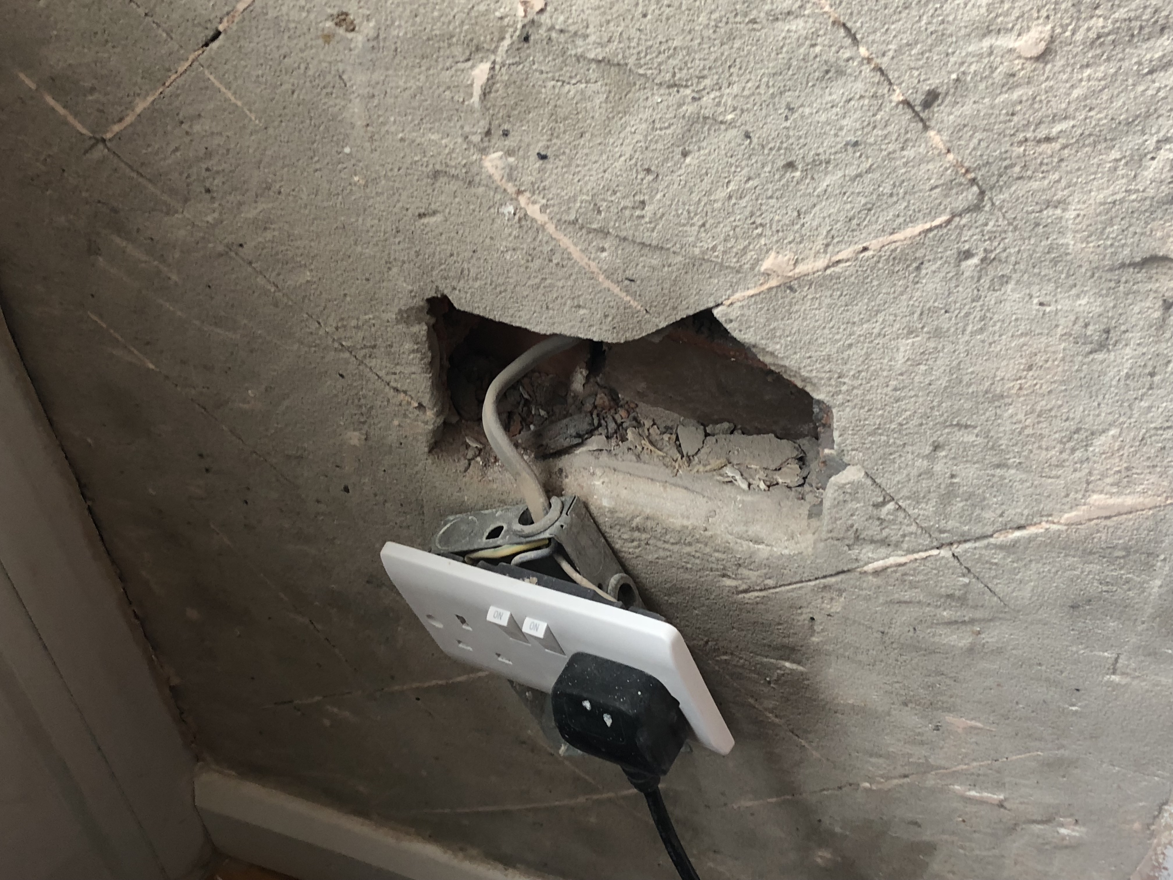

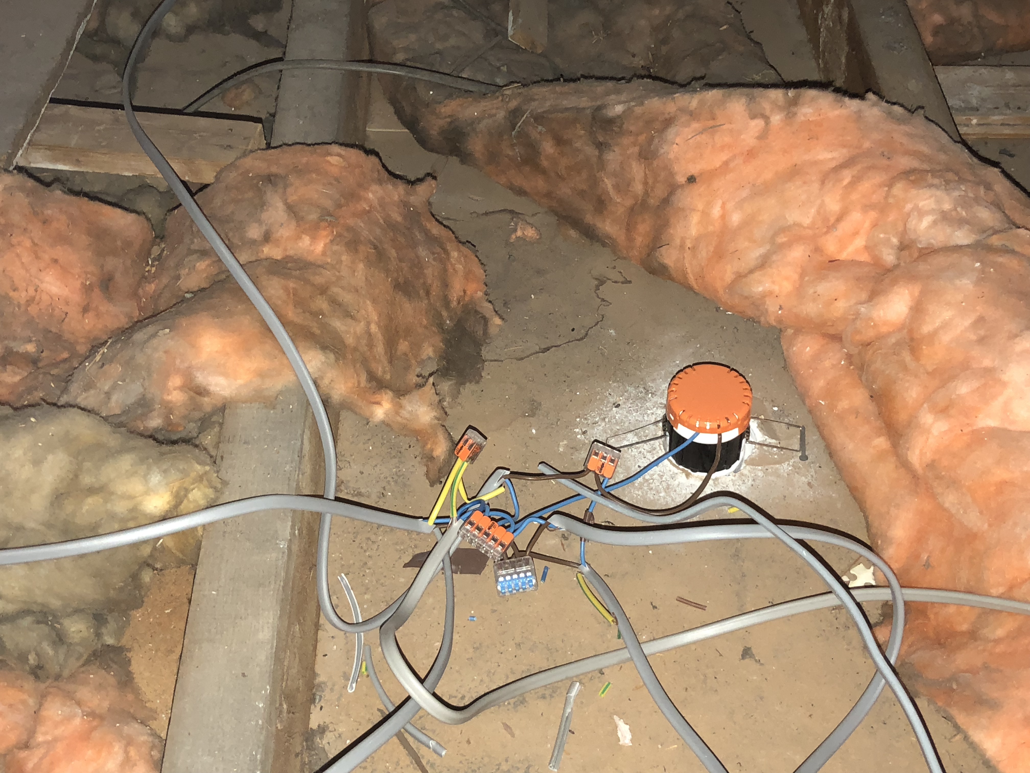

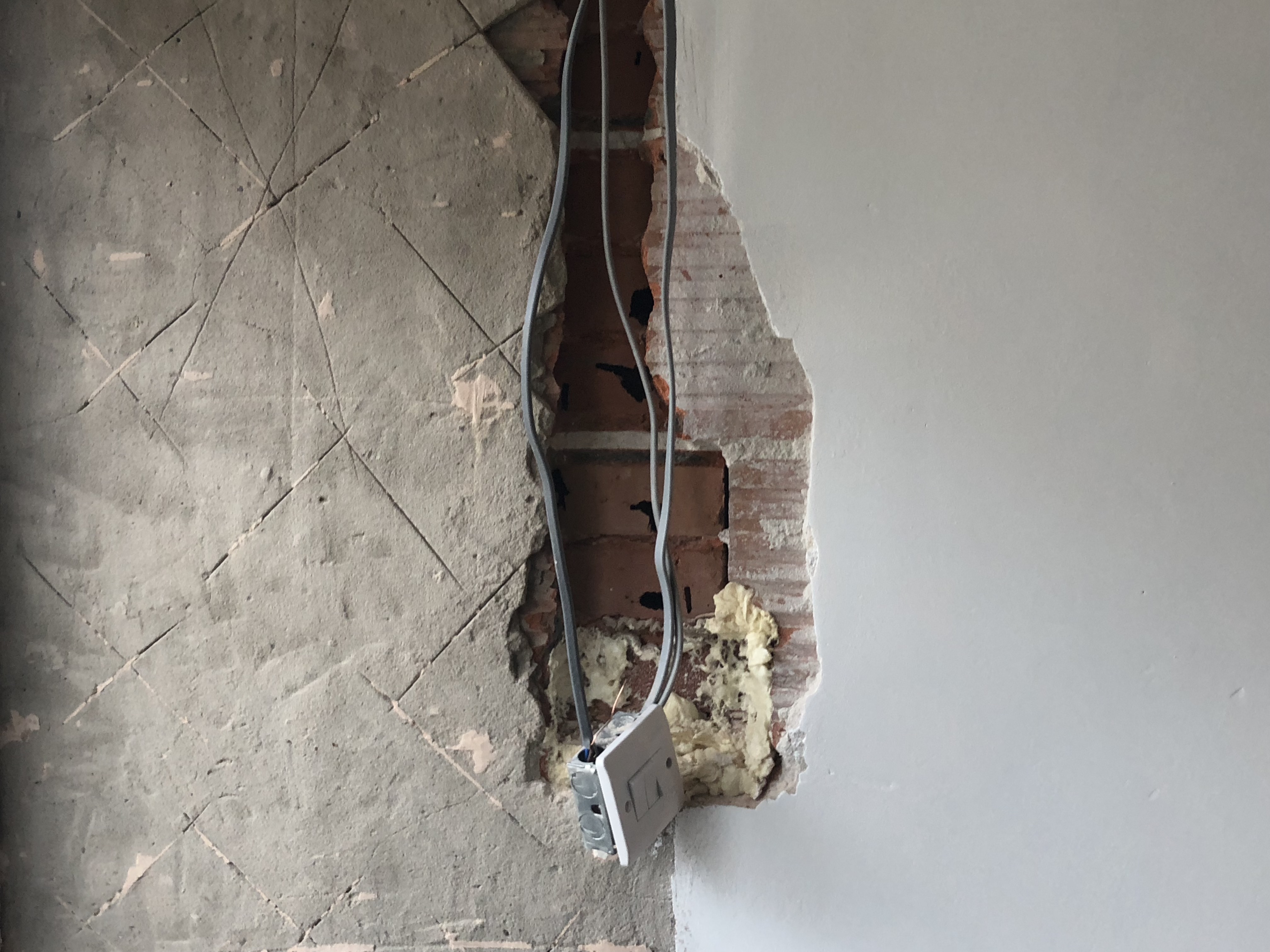

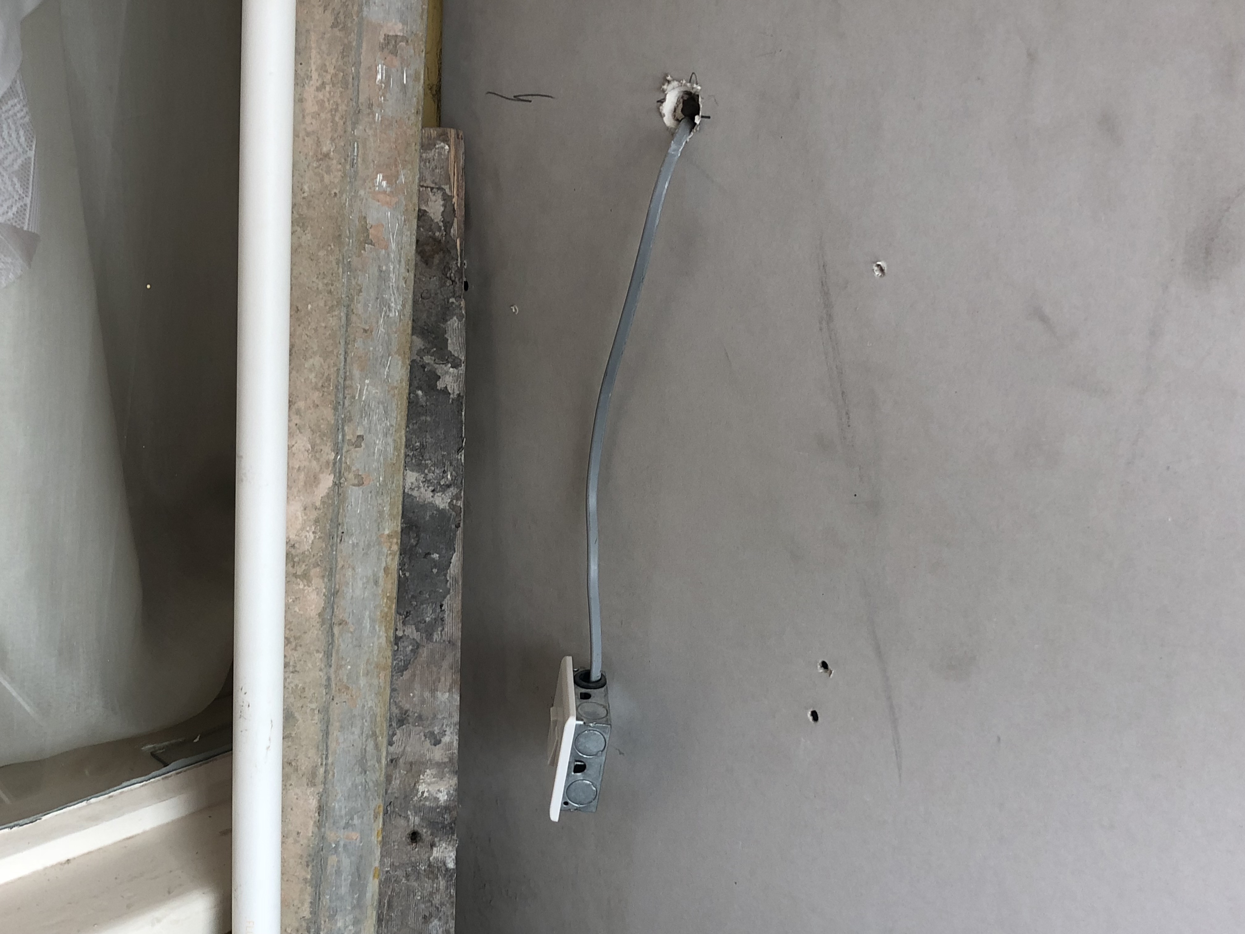

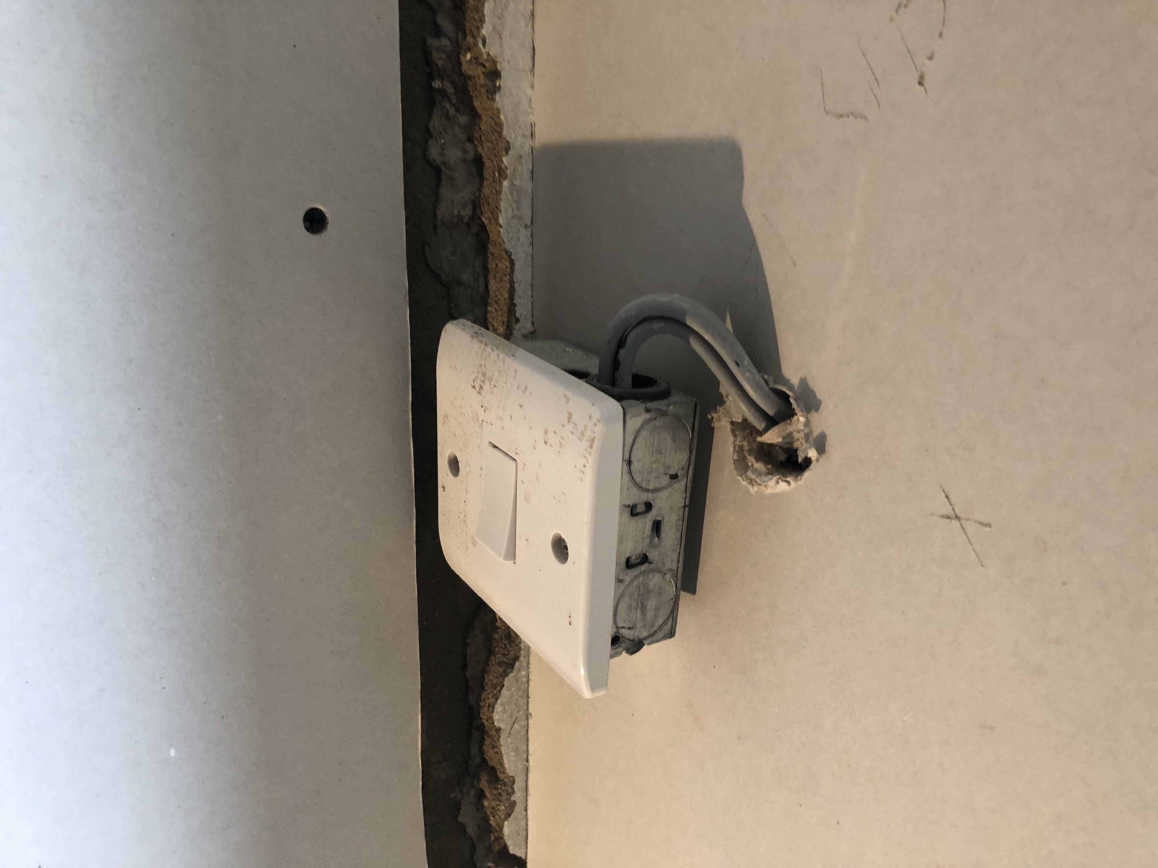

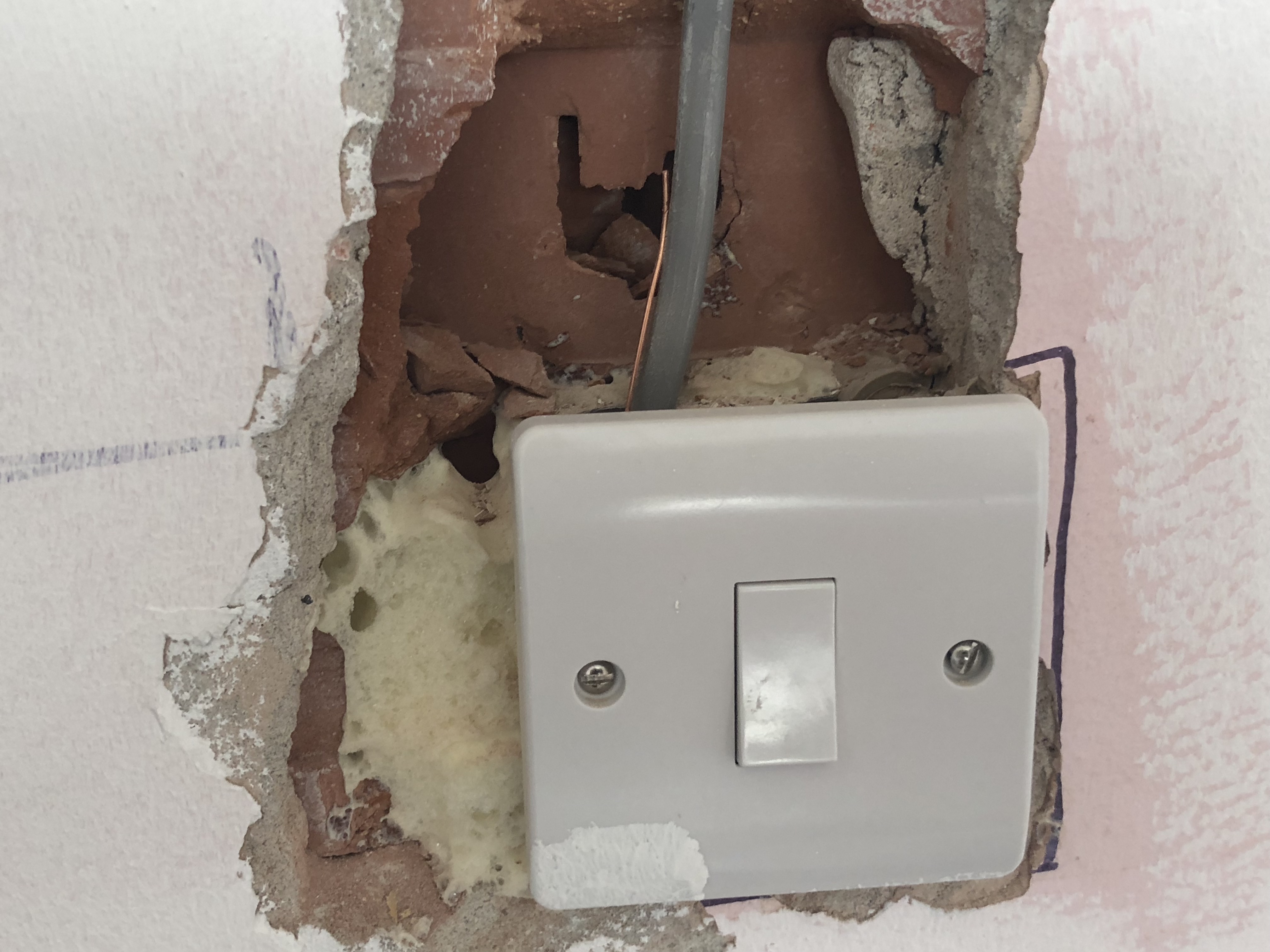

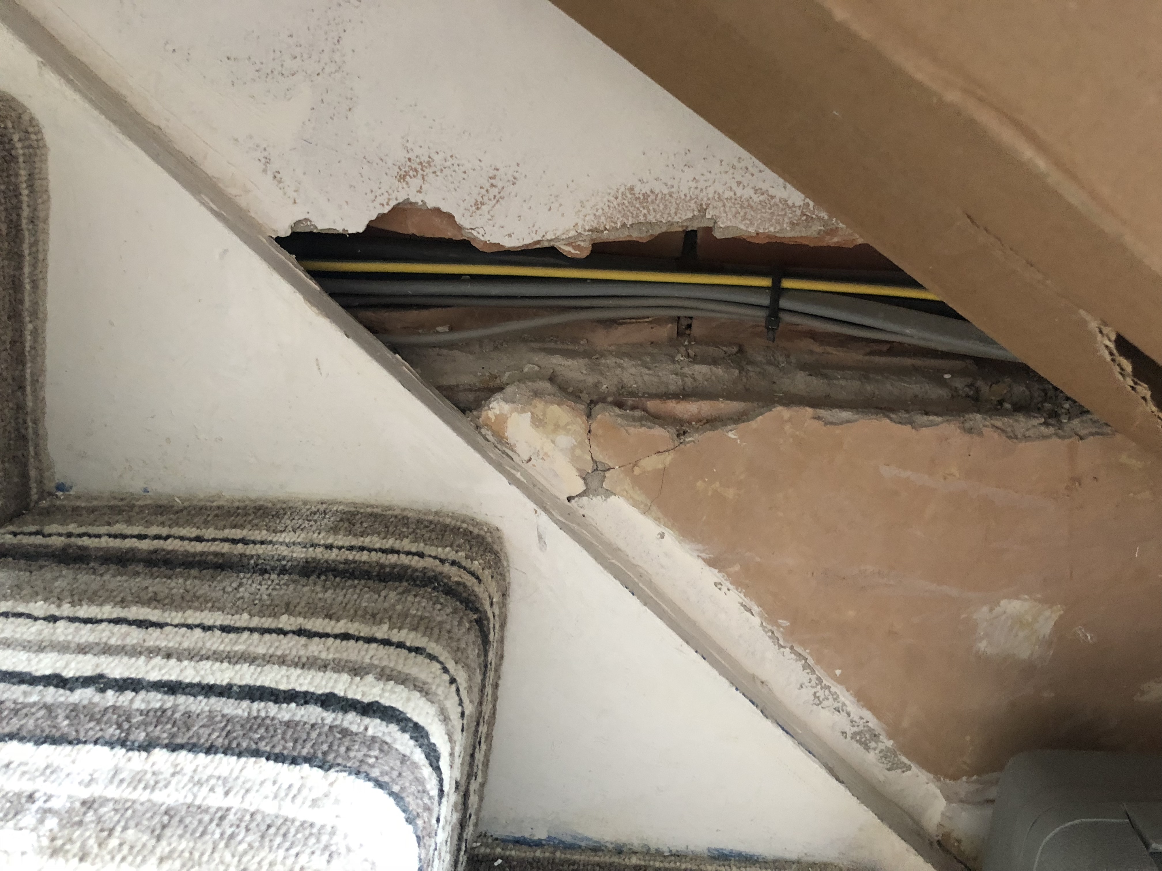

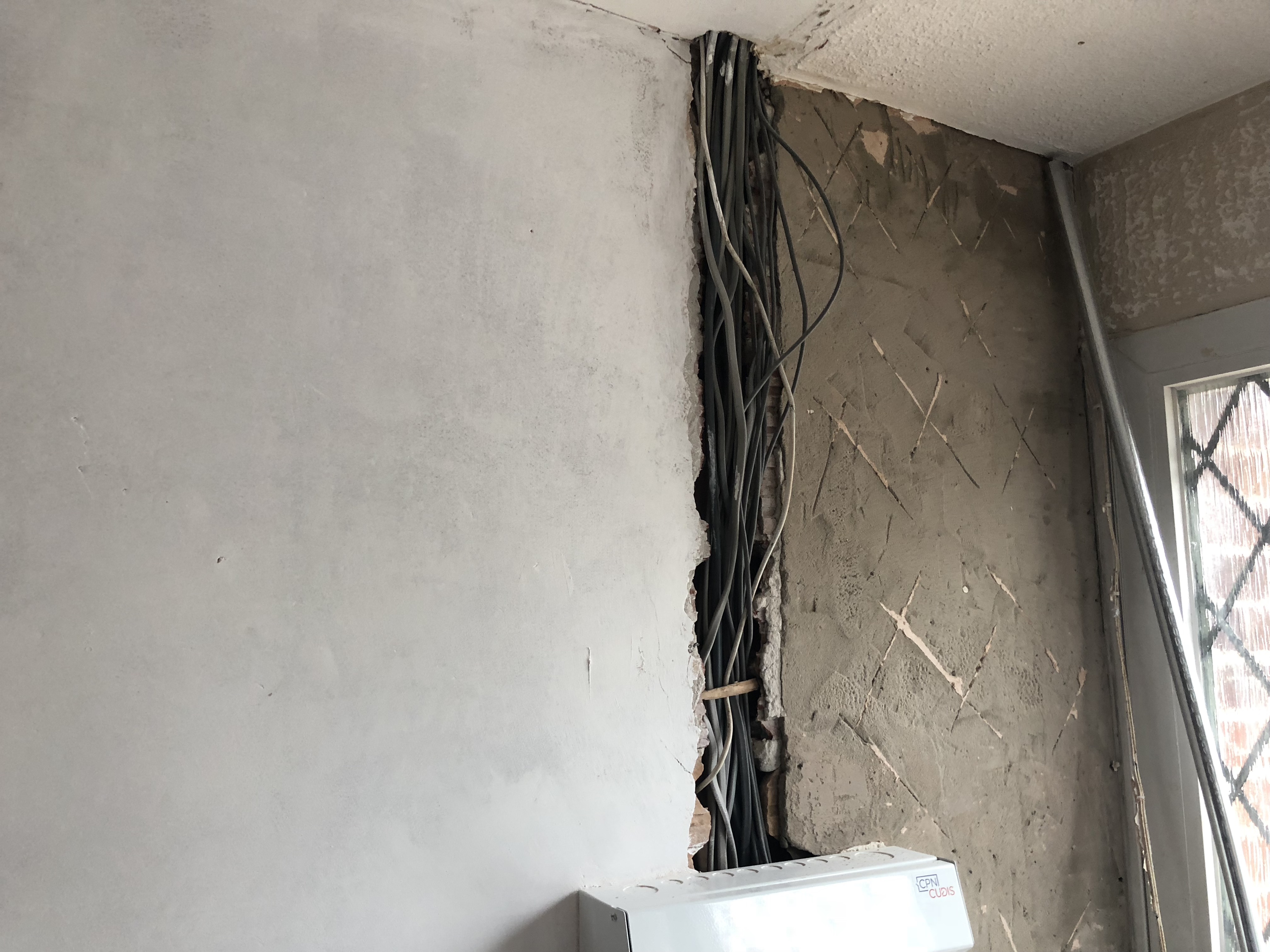

I thought you guys may be interested in these pics from a "spark" who did one of these 4 week courses and went straight to self employed!
This was for a house Re-wire, I actually quoted for this job originally but the house owner chose this contractor instead, but then contacted me afterwards to take a look as they were concerned by the work completed. :rolleyes:
When I walked in and saw the work, I was truly shocked, it was truly dangerous!
I contacted the Niceic for the homeowner who have now completely Re-wired the house with another contractor under the platinum guarantee.
Original "Spark" is no longer registered, so its good to see the Niceic do take action!
This was apparently a finished job which she has been paid in full for :eek:
Anyway have fun with these :D:
C/U was moved, so quite rightly a switch fuse was installed, not so sure on the insulation methods mind:
Urm...., oh and thats data going behind the C/U there...
Wet pants is always wrapping his pipes around my cables, I know I will wrap my spaghetti around his pipes..
Meter tails and more chased horizontally through wall, not in a safe zone..
Now what is that bare wire for, lets poke it back out of the box...
Expanding foam doesn't seem to be working at fixing the boxes..., oh and that damn bare wire again! and no grommet! o_O
Well the expanding foam wasn't working, lets just leave them hanging...
Its all too much work chopping the boxes into the wall..
Wago boxes are over-rated...
This surely has to be up there with the worst?
Hi Matt.
Did you see my post yesterday? Just wondering how you new it was someone who did a Domestic Installers course?
Did you just assume this or did you find out somehow?
Cheers.
