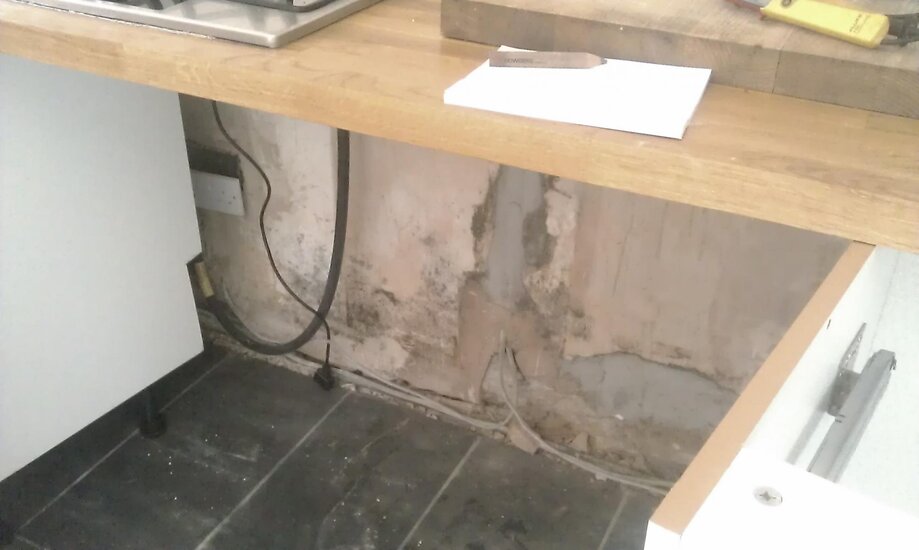

Got asked last week to have a look at a newly installed kitchen where 2 out of 4 sockets along with the oven, hob ignitor and cooker hood had stopped working. So I went to see it this morning, well what can I say, just had to hang my undies out to dry as I laughed that much!
Poor lad, thought he'd have a mate do the electrics as well as a half arsed attempt to fit his kitchen and gas to the hob.
No end to end on RFC, so out came all the base units, loose anyway cos fitter hadn't bothered to fit them anyway?

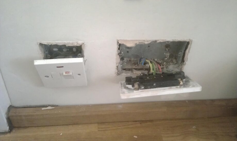

Started to chase the half plastered over cable, only to find that somewhere, his new bit of wiring is in fact taken as a spur from somewhere I couldn't find, it then feeds 1 double socket, then supplies a FCU for the cooker hood, then feeds another double stuck behind the oven, which the oven is plugged into and hob ignitor.
No bonding to either gas or water, only 3 meters from service head, and not an RCD in sight.
Anyway, after I had shown him everything that was right with it, which lasted 30 secs max, he would now like it done right.
So back end of next week I have the joy of re chasing nice newly plastered walls and lifting base units.:cool4:

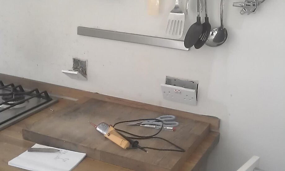

David, I take it that is your terminal screw driver in pic no4, or is it the original 'electrican's test equipment? :D
And scissors...?

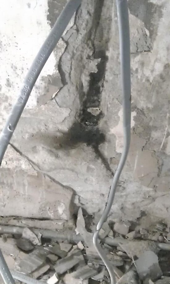

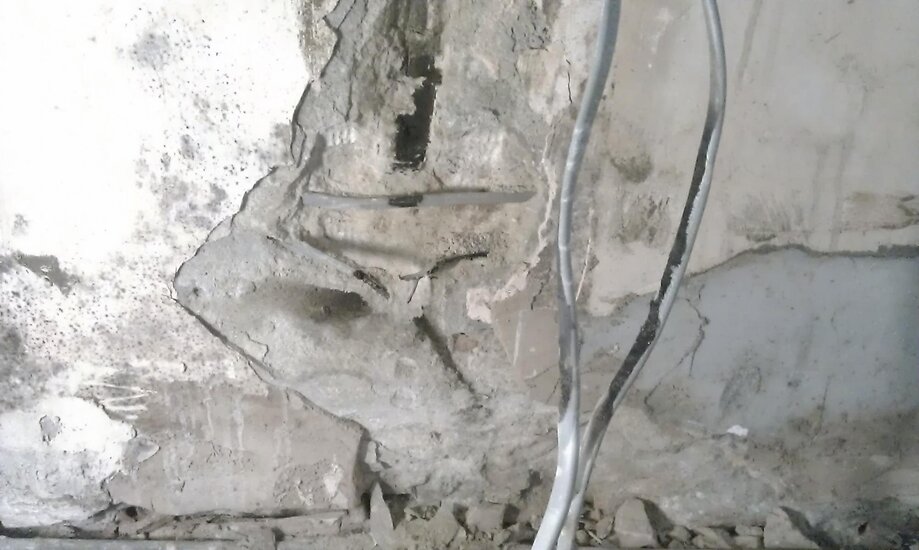

Everything on the right side of the kitchen is a single spur. Best part is the location of the joint is unknown.
Managed to trace the cable along behind the base units that are removed, until i reach the back corner of the kitchen and after a full rubble sack of plaster, was going no further trying to polish the proverbial turd.
Hence getting the kitchen rewired correctly.
was that a SCREW THROUGH THE CABLE THERE?
