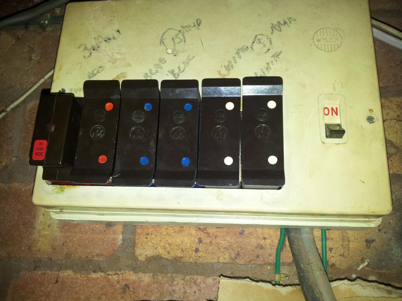

my downstairs lighting ring fuse blows randomly sometimes instantly sometimes in 10 to 20 mins. ive tried a multimeter continuation test to see if there is any contact between earth and live and neutral and live on that circuit . which there doesn't seem to be.
there is continuity between earth and neutral . this is also at the consumer box . only this fuse blows. ive tried opening up sockets and checked them for any obvious signs as well as light roses as well.
its driving me crazy.
cant seem to find the fault
any help on how to find the problem will be much appreciated. by the way the fuse first blew in the middle of the night.

So a fault has just developed??? Can you post a pic of what's tripping in the distribution board

second white fuse wire from the right keeps blowing. have to replace it with 5 amp fuse wire each time
Re: fuse blowing randomley somtimes instantly sometimes in 10 to 20 mins driving me n
If its taking out a rewirable then its overload or dead short.. Unless you can pin point it to a persific light or switch then without a tester then its trial and error..

you will get continuity between neutral and earth,unless you isolate the board,this is due to neutral and earth being connected at transformer,please note this will not apply if TT system.

don't you just love that circuit identification.

Hope that 30amp fuse on the end isn't feeding the kitchen ring or his washer and stuff will all be going backwards !!
