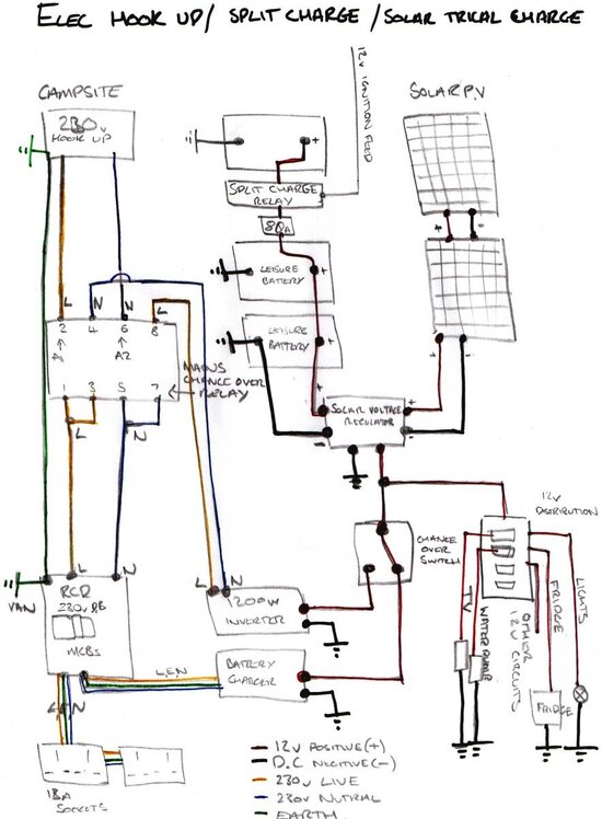

Im planning on converting a vw transporter into a camper. i plan on having 2 leisure batteries on a split charge system also a 12v P.V system to trickle charge the batterys, there will be a 230v inverter running off the batteries to power some sockets and also an electric hook up. the problem im having is i need a way to switch the inverter off and switch over to the 230v supply from the hook also switching the battery charger on, some kind of relay?? cant seem to find any where that sells the kind of components i need.
Attached is a quick diagram of what im trying to achieve, this is just the first design so if anyone has any ideas on what components to use or circuit design it would be most appreciated.
Thanks Chris
