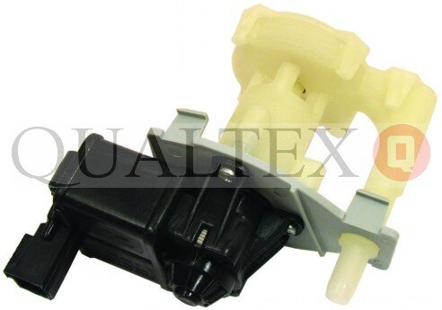

i have a creda tcr2 tumble dryer and wasnt drying clothes properly, so done some reading and was able to check element which 1 out of 3 elements was intact, so i replaced at a cost of £50, now the water is not going into the container so after researching again i think its the water pump which i have located at the back of the machine but its now another £30. does any of youy guys got any good advice for me in fault finding on appliances. my sister has a service contract on her tumble dryer and the guy comes and uses laptop.
so real question is can i get thiis same information anywhere or does fixing appliANCES come with expierience.. thanks

well ive ripped of foam seal between drum and back pannel as has burn marks and the pump at the bottom right hand corner of back pannel is different from one that it reccomends. had the whole unit stripped today , would turning it on now without back seal be a bad idea??? thanks

pump is £18,filter is £9,heater is £28, dixon course not worth it really u will learn more from getting cheap machine off flea bay for spares or repair one then ask advice if get stuck once done u get hang of it, i do recon machines pay 10 quid for them parts cost no more than 20 quid then sell for 120 quid, cookers are easy pay 20 quid for one with ceramic hob put main oven element in for 5 quid sell for 200 quid
