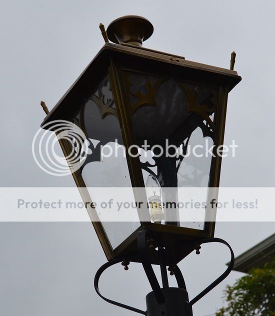

There is no reflector, the lamp looks like this:
The 'fitting' in the middle for the bulb is EXACTLY as shown in that picture and the only connection under the fitting is 1mm flexible cable that leads down into the pillar/wall to which it is fitted. There is nothing ballast or ignitor related within the lamp itself.

Is that picture of the actual lantern because that looks like a filament lamp.
No, I haven't been back to the property yet thats the closest thing I could find online, the bulbs in question are definitely Metal Halide

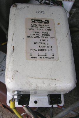

This is what we use, sorry i couldn't find a picture of the smaller version.ballast.jpg
They usually show 230v output if the internal 'ignitor' part has failed, which won't strike a sox lamp, but would illuminate any lamp not requiring a strike voltage.

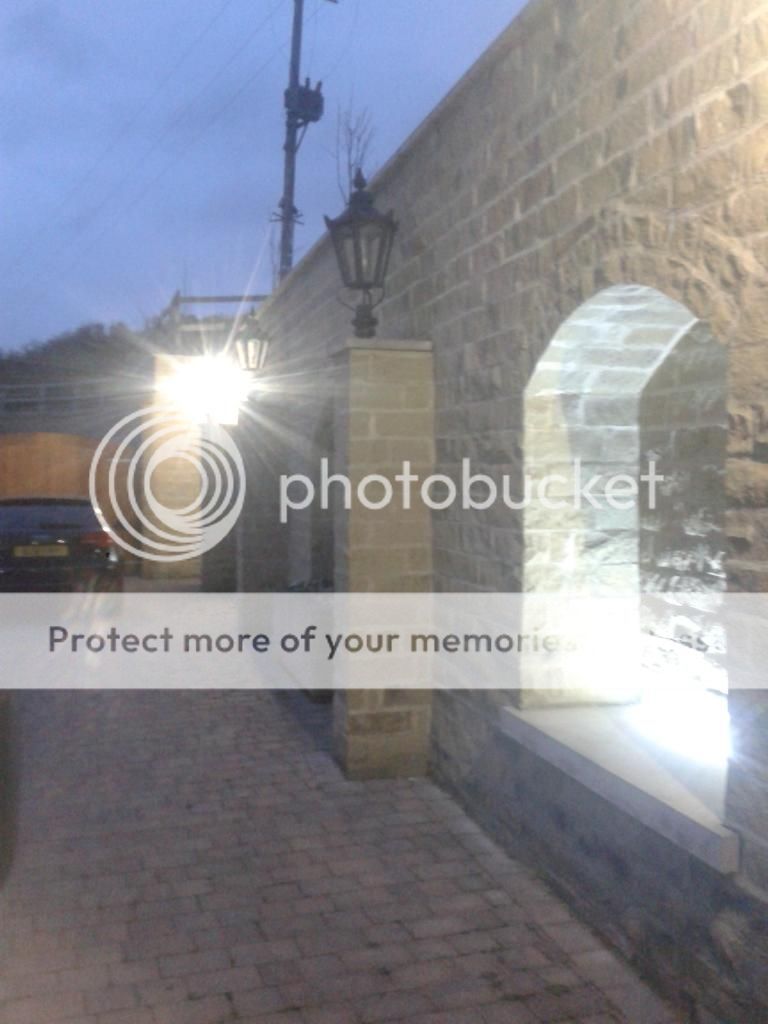

What is the maximum distance from the lamp that the ballast can be fitted? From the pictures above I'm guessing the ballasts are either inside the 'pillars' or in the room with the switchgear for the property (which is over 10M away).
I've worked in this room before and have never noticed any ballasts (the property is pretty much wired for sound, literally...) but I guess some digging may unearth something. From my recollection the courtyard lighting circuit is controlled by a photocell but the actual load wiring leaves the DB in SWA which goes under the driveway.
