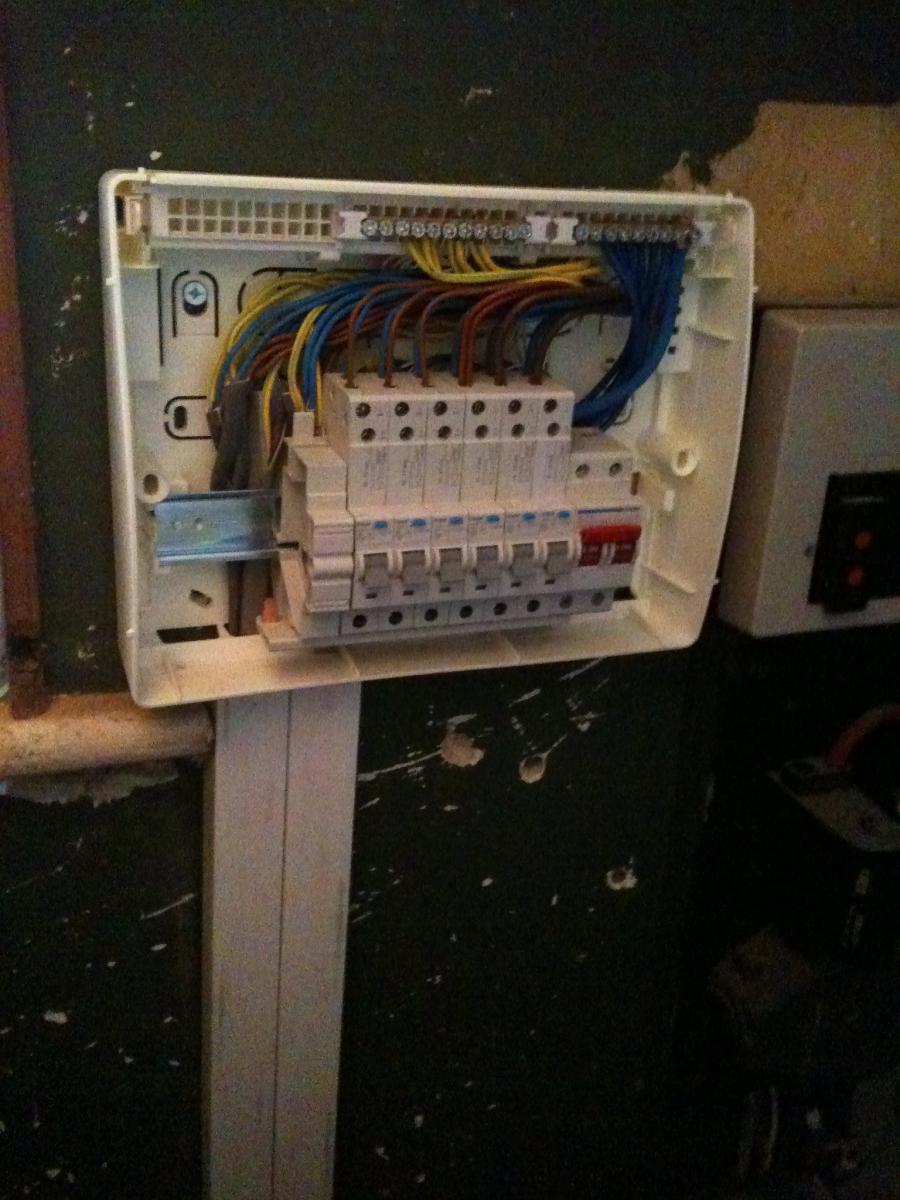

Hello as above really, looking for something with some space inside so can make a tidier job of dressing cables. Quoting for a job that will have 12 RCBOs fitted needing to leave a few spare ways. Wasn't too happy with the last one with the neutral and functional earth fly leads in there too (9 circuits in a 12 way board). Not really too sure if a double stacker board would be suitable? Any recommendations appreciated! Thanks
I did my first CU change for ages and boss got me a Hagar cu (I think neweys are hagar as well) and I found loads of room commercialy I like the single phase M.G. dbs with sliders and top FIXED busbar
I support the views on Hagar. Recently put in a Controlgear one which was very good with lots of space and they do an extra height one for RCBOs to make it even easier and probably much cheaper than the Hager.
Hager oodles of space :D
think they are Volex / Wylex - which is why I avoid them (or anything electrium in fact)
Always been a big fan of Hagar and I like the Merlin Gerin distribution boards because of the sliders too. Although, once you filled a 18 way 3 phase board with wires it’s petty much impossible to get to the earths.
