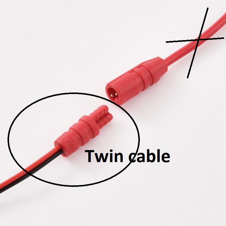

I am trying to find some connectors, male with female contacts, supposedly IP67 known as 07A11, I am only looking for 4 or ideally 6 as per the photo here:
These are available via alibaba, but at a minimum quantity of 1000 ($350 USD)
dimensions are as below:
I can't actually find them anywhere else (all paths lead back to 1000 min qty).
Has anyone seen these used on any kit or small products, happy to buy stuff to throw away if I can get these plugs off them - I could manage with 2 but ideally want 6.
Seems to need 09b-1 adding to get the shape of keyway.
Plain 07A11 has a flat keyway
07A11 09B-1​
Still doesn't solve the 1000 / 2000 minimum order or out of stock.

You could be cheeky and ask the factory if they could send a few samples for you to evaluate.
Reactions: DPG and Avo Mk8
Well as it happens... I did!
But a no go unfortunately, I have asked them to let me know of any of their customers using this where I could buy their product, to just get the plugs.
Waiting for a reply.

So I got nowhere with getting these connectors, but fortunately (ish) I have a husband who owns a lathe and milling machine!
In the end they cost around £8, from £5 for the delrin rod, and £3 for brass tube (for the contacts).
I can now either make plenty more, or does someone want to buy some brass tube 1.1mm id, 1.5mm od, I have 1 3/4, 300mm lengths left, one careful lady owner!
