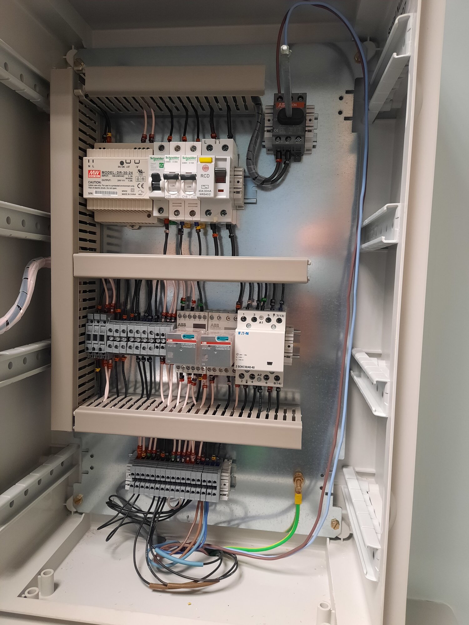

One of my common jobs is preparing the wiring for the installation of dental X-ray equipment and removal and disposal of the old equipment.
Typically a good mornings work, supply from an existing SFCU to the operator position (either above a ceiling or surface trunking) and a data cable run, all in the same room.
So at worst a couple of <10m MT2runs, the best was changing 3m of cable in the same trunking, off site in 90 mins.
Depending on milage a £500 job.
Essentially the same job, to the same standards but NHS.
Just bear in mind this is a single entry 3mx3m room.
Must now have a local two stage warning light, even though any interloper would have to pass the operator at the door.
Three point E-stop, one at X-ray, one on panel( no more than 1.5m from the other two) and one at operator position.
Start/stop and power on indicator at operator position.
All earthed via a clean earth EMB, in enclosure.
This is the panel.

You getting £5k or it costing you £5k?
Interested to more about that switchgear setup.
That is an existing control panel, the company that made and installed it had quoted £5295 to install a second and the associated E-stops, warning light and start/stop.
Their quote was accepted but three years down the line they have yet to carry out the job so it's been offered to us.
I think that panel design can be tidied up a little, additional functionality.
I'd like to reconfigure the contactor so that if the stop is hit then the system has to be powered back up from the panel, to stop unauthorised people just pressing buttons in the corridor, but otherwise its just shameless plagiarism.
